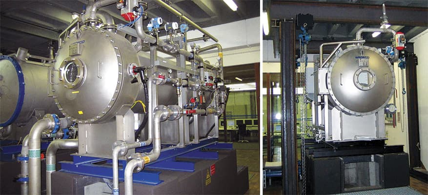

Ozone GeneratorImage 1. Ozone generator with a maximum ozone production capacity of 21,600 gallons an hour from liquid oxygen at a concentration of 12 percent by weight at Langenau, Germany (Images courtesy of Xylem)

One of Germany’s largest water supply companies, Landeswasserversorgung, selected a state-of-the-art ozone system when upgrading its Langenau treatment plant. The plant treats the drinking water supply for more than 250 cities and towns, including Stuttgart, Ulm and Aalen, with an annual output exceeding 90 million cubic meters (m3), or about 23,775 million gallons per day (mgd). River water from the Danube River is disinfected using a combination of flocculation, ozonation and multilayer filtration. The system selected for the upgrade consisted of an ozone generator with a maximum ozone production capacity of 21.6 kilograms per hour (kg/h), or 1,143 pounds per day (ppd), of ozone from liquid oxygen (LOX) at a concentration of 12 percent by weight. Ozone is injected using a complex system of injectors followed by several static mixers, covering a large range of flow conditions and providing standby capacity. The system has facilitated treatment of a raw water flow of up to 7,200 cubic meters per hour (m3/h), or 46 mgd, with an ozone dosage of 3 grams per cubic meter (g/m3) for disinfection, odor removal and improvement of taste.
