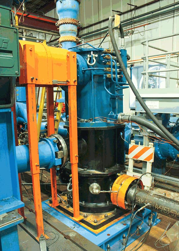

Image 1. System performance and NPSH testedImage 1. System performance and NPSH tested per API Standard 610. (Image courtesy of ITT Goulds Pumps)
