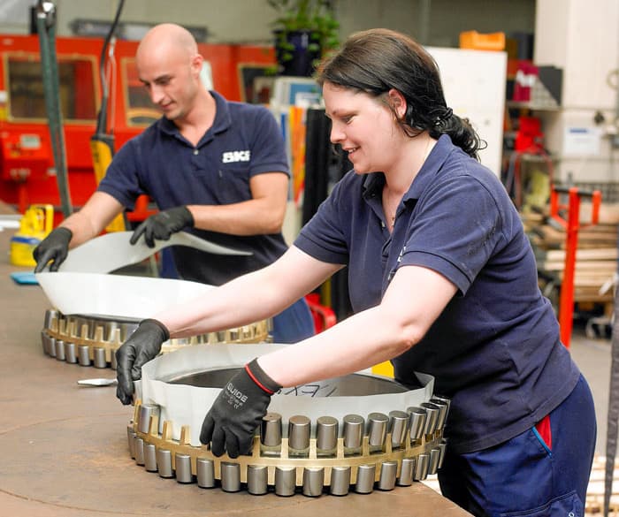

pump bearingspump bearingspump bearingsImage 1. In general, pump bearings support hydraulic loads imposed on the impeller, the mass of the impeller and shaft, and loads due to couplings and drive systems. (Image courtesy of SKF)
