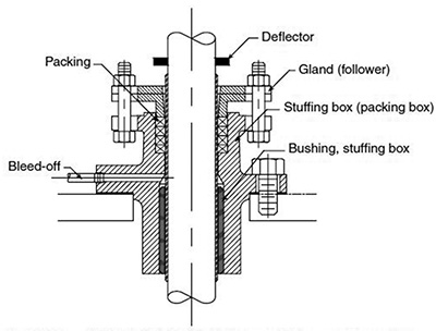

Stuffing box for low to intermediate pressure serviceFigure 2.3.3.7.4a. Stuffing box for low to intermediate pressure service
The type of stuffing box in Figure 2.3.3.7.4b is used to provide water injection to the shaft-enclosing tube (inner column). A provision for grease injection to the lantern ring near the lower end of the packing ring stack is optional.
Stuffing box with injectionFigure 2.3.3.7.4b. Stuffing box with injection
Other special-purpose packed stuffing boxes provide cooling, throat bushings, quench glands and other special features for the particular application conditions. Packed stuffing boxes are normally limited to moderate pressures and temperatures and require a slight leakage for packing lubrication and cooling. Care is required to adjust the packing gland to avoid shaft sleeve and packing damage. The number of packing rings in the stuffing box, together with the size and type of packing vary by manufacturer. In most cases, it is recommended that specifications leave open the exact details about the number of rings or the size or type of packing and allow the pump manufacturer to make recommendations based on application experience. For more information on this topic, see ANSI/HI 2.3 Rotodynamic Vertical Pumps of Radial, Mixed, and Axial Flow Types for Design and Application. Q. What factors influence rotary pump operating temperature? A. The maximum allowable temperature is determined by the materials of construction or elastomers. Rotary pump performance is a function of the viscosity of the pumped liquid. If the viscosity and temperature of the pumped liquid and the maximum temperature capability of the pump are known, the temperature of the pumped liquid at suction and discharge can monitor these potentially harmful conditions:
