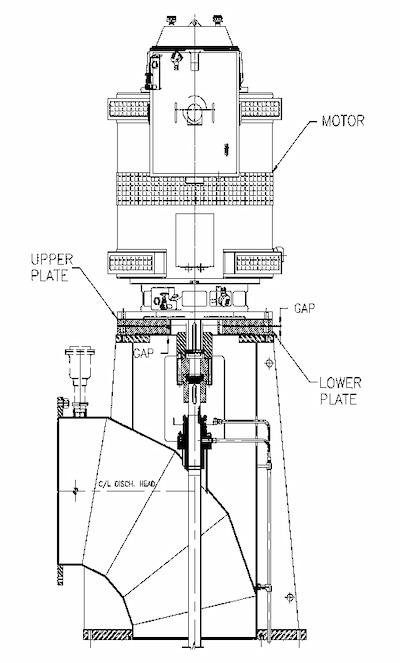

In this type installation, one of the easiest and most inexpensive places to affect a change in natural frequency is at the interface between the discharge head and the driver. A detuning device for this type pump system consists of two carbon steel plates (sometimes called spring plates) mounted between the driver flange and the pump driver support flange of the discharge head. A gap between the cantilevered portions of these plates adds flexibility to the system—like a pair of springs acting in series—reducing system stiffness. To illustrate the engineering and application of detuning devices, consider the following circulating water pump application at a Midwest U.S. power station.

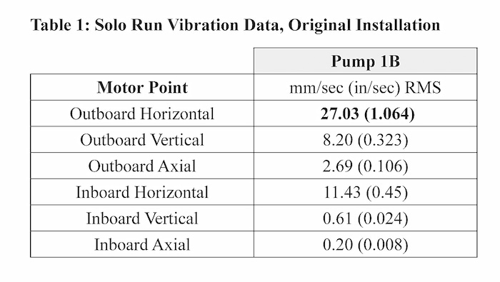

Despite careful engineering, two vertical circulating water pumps exhibited higher than expected vibration levels shortly after installation (see Figure 2). Engineers performed thorough vibration analysis on both units, revealing high amplitudes in both systems, the most severe being in Unit 1B. Measurements for Unit 1B are shown in Table 1. To identify and confirm a resonance issue, consulting engineers engaged in the following field testing and analysis.
Figure 2. Original pump installation at the power generation plant
Impact Testing with a Calibrated Hammer

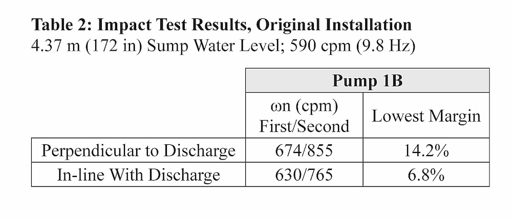

In this method, engineers strike the pump system at multiple locations using an instrumented hammer and use a vibration sensor and a vibration analyzer for measurement. This method of striking a system with a mass and measuring its response is common for determining natural frequencies in mechanical structures. Best practice requires that the impact testing take place at multiple locations on the structure to identify several resonant frequencies. This test must be performed with the pumping equipment off. The recorded first and second natural frequencies are shown in Table 2.
Table 1. Solo run vibration data, original installation
Table 2. Impact test results, original installation

Using advanced mechanical and stiffness analysis techniques, consulting engineers determined the appropriate size, thickness and gap widths for the plate assemblies. An engineering model of the modified system was developed to confirm the maximum deflection levels to assure that the cantilevered portions of the mating plates would not touch under any condition. Finite element analysis (FEA) was performed to confirm system parameters—the predicted system natural frequencies and mode shapes at operating conditions. This analysis considered:
  • The base geometry of the motor support, discharge head, bowl and suction bell
  • The mass of the fluid in the pump, sump and discharge head
  • An equivalent model of the driver (by mass and center of gravity), including reed frequency
  • The sump geometry and mass, including concrete properties
Figure 4. Arrangement drawing for detuning devices
Figure 5. Installed detuning devices

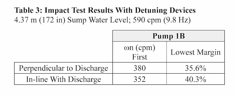

Figures 4 and 5 show the detuning devices in the pump assembly. Once installed, engineers repeated the impact and peak-hold coast down tests to validate that the natural frequencies of each pump system had been sufficiently reduced to eliminate resonance issues. Field test results for Pump 1B are shown in Table 3 and Figure 6. Testing showed that the margin between the system’s natural frequency and operating speed was increased to a comfortable 35 to 40 percent, significantly better than the accepted minimum standard of +/-25 percent.

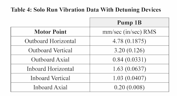

Of course, confirming reductions in actual vibration levels once the system was operating again was the most important measure of success. A thorough analysis was performed under normal operating conditions, and the results confirmed the efficacy of the detuning plates, with all vibration measurements well within established acceptance criteria (see Table 4).
Table 3. Impact test results with detuning devices
Table 4. Solo run vibration data with detuning devices
