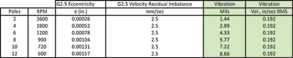

  • Vibration response varies linearly with the motor balance grade. This is expected from Equation 1, and the results in Tables 1 and 2 confirm this. Note that a motor balance grade of G2.5 yields values 40 percent of those achieved with balance grade G6.3.
  • From Tables 1 and 2, the vibration response obtained is constant across different pump design operating speeds when units of velocity are used. This is expected because the excitation is constant velocity-based values of motor imbalance (balance grade). Usually higher speeds involve smaller pumps and slower speeds involve larger pumps. The results encompass a range of pump sizes. The topic of units of vibration useful for the purpose of standard acceptance criteria is discussed in the second part of this series.
  • From Tables 1 and 2, the vibration response obtained with units of mils peak-to-peak is not constant but varies with the design operating speed. Again, the results encompass a range of pump sizes. The topic of units of vibration useful for the purpose of standard acceptance criteria is discussed in the second part of this series.

Table 1. Results from example one
Table 2. Results from example two
