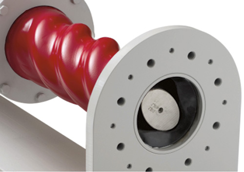

A progressive cavity pump with even-wall spiral stator technology and a 2/3-elliptical stator and rotor

In general, two types of stators can be used in progressive cavity pumps—a standard, round stator and a spiral-designed stator (see Image 1). Standard, round stators have been used for 80 years. Spiral designs are a recent development, and only a fraction of progressive cavity pump manufacturers offer this option.
Image 1. The spiral stator (left) allows for higher pressure per stage, and the 2/3-elliptical lobe and rotor generate a higher flow rate than the standard, round stator (right).
Spiral technology often offers higher efficiency and higher pressure and flow capabilities. This technology’s stator has a much thinner rubber lining. A standard round stator has a much thicker layer of rubber inside. The lining of the spiral stator pump is even all around the stator. Standard stator pumps require much lower tolerances than spiral stator pumps—also called even-wall progressive cavity pumps. Lower tolerances result in less efficiency and more wear in round stator designs. Traditional, round stators also suffer extreme wear during startup. For instance, highly abrasive materials will slip or leak backward because of the cold rubber, which has not heated or expanded. This expansion of the thicker rubber in the stator is required to tighten the tolerances to allow more efficient pumping. During this time, the pump will suffer more wear or damage. With even-wall technology, these extreme tolerances are not required. The even-wall technology is more efficient at startup and during normal operation.

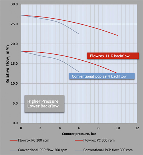

Figure 1. Relative flow (m3/hr) versus counter pressure (bar)
Improved Hydraulic Performance
When comparing the hydraulic performance of an even-wall progressive cavity pump to a conventional progressive cavity pump, the even-wall technology results in higher pressure, lower backflow and higher efficiency. Figure 1 compares the relative flow (cubic meters per hour) versus the counter pressure (bar). The relative flow rate drops as the pumps’ counter pressures increase. This trend reflects how the pumps’ hydraulic efficiency decreases because of the counter pressure increase. When comparing the hydraulic efficiencies of both pumps at 6 bar (88 psig), the conventional pump results in an efficiency of 81.6 percent while the spiral stator progressive cavity pump has an efficiency of 93.6 percent. The results at a counter pressure of 10 bar (150 psig) are similar, resulting in a higher pressure with lower backflow for the spiral stator technology.

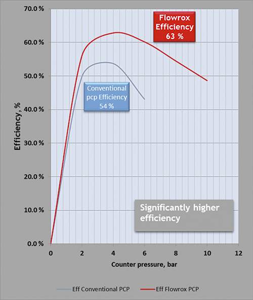

Figure 2. Efficiency (percent) versus counter pressure (bar)
Figure 2 shows the total efficiency difference measured from pump power demand. The conventional pump’s maximum efficiency is 54 percent, while the even-wall progressive cavity pump has a significantly higher maximum efficiency of 63 percent. Higher hydraulic efficiency reduces the energy consumed, and it facilitates a longer pump service life. Backflow can cause a high degree of wear. The even-wall progressive cavity pump will have a longer service life because of the minimized backflow between the rotor and stator. All the features discussed in this section improve pump performance but also increase pump costs. Depending on an application’s parameters and conditions, end users must select the features that are required for their process. Progressive cavity pumps offer many advantages. Some are high flow delivery in a small package, the ability to handle significant slurries and relatively low cost. Part Two of this series discusses peristaltic pumps and how they can be a good choice for handling solids in many industries.
