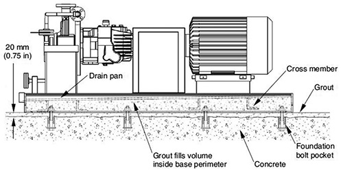

Economics may initially be difficult to assess until operating, maintenance and monitoring expense experience has been gathered. Records of these considerations are valuable to the pump selection process. For more information about rotary sealless pumps, see ANSI/HI 4.1-4.6 Sealless, Magnetically Driven Rotary Pumps for Nomenclature, Definitions, Application, Operation, and Test. Q. What are some baseplate designs and considerations for rotodynamic pumps? A. Baseplate designs for rotodynamic pumps include the grout type and the non-grout type, among others. The grouted baseplate is designed to allow grout to be poured under the base. The grout placed inside the base contributes to the baseplate’s installed rigidity and damping. See Figure 1.3.8.2.1a.
Grouted baseplate, fabricated steelFigure 1.3.8.2.1a. Grouted baseplate, fabricated steel
The cross members used on this type base are normally designed to lock into the grout to further resist baseplate deflection or vibration. Typically, the cross-member geometry chosen to achieve this is an L-section (shown in Figure 1.3.8.2.1a), a T-section or an I-section.

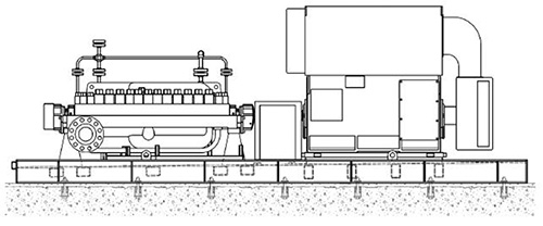

Non-grout baseplateFigure 1.3.8.2.2. Non-grout baseplate
If the baseplate is a closed design (for example, grout cannot be poured inside the baseplate perimeter because of the presence of a drain pan or deck plate), then grout holes must be provided to allow the grout to be placed inside the base. The grout used may be either cementitious or epoxy-based. The surface preparation required for a baseplate to successfully bond to the grout is different depending on which grout will be used. Therefore, the vendor and customer must agree in advance which type grout will be used. The baseplate in Figure 1.3.8.2.1a is typical of a fabricated baseplate. Cast-iron baseplates are another example. The ability to integrally cast in features—such as bracing, grout holes and sloping surfaces—provides a highly functional and economical solution for many applications. The non-grout baseplate is placed directly on a foundation without the use of grout to fill the interior of the base to lock it to the foundation. Because of the loss of stiffening normally provided by the grout, non-grout bases must typically be structurally stiffer than comparable grouted bases. Cross members do not need to lock into the grout and, therefore, may be selected on the basis of providing the best stiffening effect. For this reason, hollow rectangular sections are often used in this design. The advantage of this design compared to a grouted design is simplified installation. The structural design must be stiffer than an equivalent grout-type base. Additionally, the structural natural frequencies must be separated from any equipment operating frequencies. This is because the stiffening and dampening effects of the grout are not available. The non-grout type is often used in offshore installations in which the mass of grout and concrete must be avoided. This type can be provided for all types of rotodynamic pumps. (A multistage, axial-split, between-bearings pump is illustrated in Figure 1.3.8.2.2). For more information about other baseplate designs—including pre-grout, sole plate and freestanding—see ANSI/HI 1.3 Rotodynamic (Centrifugal) Pumps for Design and Application. Q. What kinds of impellers are used in slurry pump applications? A. Both semi-open and closed impellers are used in slurry services. The control of leakage into suction is usually accomplished with a combination of clearing or expelling vanes on the impeller and close axial clearances. Because these axial clearances increase with wear, pumps should be arranged to allow simple clearance adjustments to maintain performance. Close radial clearances wear quickly when solids are present and cannot be easily corrected with external adjustment and should only be used on low concentrations of fine slurries. An axial clearance arrangement between the impeller inlet diameter and liner is common for providing leakage control for high-wear services. Impeller attachment methods vary by manufacturer and service requirements. Different bolted designs and threaded designs are used successfully. When pumping highly abrasive slurries, the impeller attachment should be protected from wear to optimize life. An internally threaded impeller is typically used in high-wear services for this protection. Balancing requirements for slurry pump impellers are different than those for clear liquids. An impeller balanced for clear-liquid service is expected to remain substantially in balance for most of its operating life. As a slurry pump impeller wears, it will naturally begin to change its balance because of the erosion of the metal along the wear surfaces. As a result, the bearings and shafts in a slurry pump must be designed for a large amount of impeller unbalance. In general, slurry pump impellers will be balanced to a lesser standard (higher residual unbalance) than a clear-liquid impeller. The levels of residual unbalance allowed are determined by the manufacturer and are based on a number of operational and design factors. For more information, see ANSI/HI 12.1-12.6 Rotodynamic (Centrifugal) Slurry Pumps for Nomenclature, Definitions, Applications, and Operation.
