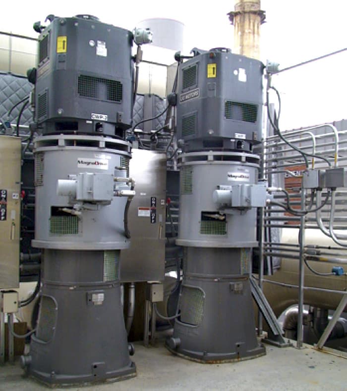

Vertical Turbine MotorsImage 1. Vertical turbine motors mounted on isolation flexure plates(Graphics courtesy of EASA)

There are several common resonance mode shapes for vertical turbine pumps, one of which is shown with accompanying vibration vector data in Figure 1. In this case, flexure of the base plate is the source of the resonance, so corrective measures should be directed there. This condition can occur when grouting deteriorates between the base plate and the foundation, or when a pump is not grouted properly. Other locations where flexure may indicate a resonant condition are the section of the discharge elbow that supports the drive motor and the motor mounting flange. Image 1 shows vertical turbine pump motors with flexure mounting plates that introduce a natural frequency below the operating speed. This isolates the motors from the pumps, preventing them from contributing to resonance below their mounts.
