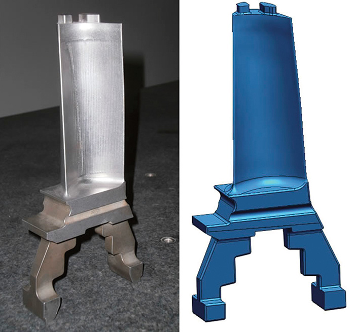

A Melrose Park, Ill., turbine parts supplier, Power Plant Services, uses a handheld scanner to reduce the time required to reverse engineer turbine blades by 60 percent. In the past, the production of a 3-D file from a customer’s turbine blade took the company 15 hours. However, that has changed. Power Plant Services engineers and manufactures high-performance alternatives for original equipment manufacturer (OEM) turbine parts and systems and supplies a wide selection of other parts and services to the power generation, pulp and paper, petroleum refining and steel industries. The company produces more than 10,000 parts per year and has performed repairs on major turbine components for more than 40 utility plants.
A portable scanning device capable of capturing 3-D geometry from objects of almost any size or shape
“By switching to this laser scanner, we can produce an accurate CAD file in only six hours, which makes it possible to deliver a new blade to our customer one full day faster than was possible in the past,” says Chad Fisher, project manager for Power Plant Services. “That time saving can result in significant cost savings for the company’s customers.” Delivery time is critical because end users and operators often place their orders after the equipment has failed, which can sometimes cost thousands per day in lost revenue. “Previously, we used a contact probe to measure part elevations point by point in different cross-sections of the airfoil and entered the measurements into solid modeling software,” Fisher says. “Then we created lofts between the elevations. We felt that laser scanning could improve this process by capturing the entire profile of the airfoil and eliminating the need for measuring elevations and lofting. We looked at several different models and selected the handheld scanner because of its portability and because the company provides a complete solution, including both hardware and software. We only have to work with a single organization for support. “The handheld scanner substantially reduces the time required to reverse engineer airfoils and other parts. Since we began using it, we save about nine hours per part, and we are also more confident in the results because we get many more points of data than in the past. In many cases, we are able to save our customers money by getting their turbines up and running a day earlier than was possible in the past. Another advantage is that the portability of the scanner means that we can now go to our customer’s facility to reverse engineer parts that are too big for shipment.”

Actual-blade (left) and the scanned blade (right)
