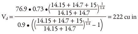

Calculate Pressure Changes
Two formulas should be considered when calculating pressure changes in the gas: If the pressure changes happen slowly, the gas temperature will have time to equalize. This is an isothermal process. The equation is: Where P1 and V1 are the initial states, and P2 and V2 are the final states. The other formula assumes no heat transfer from the gas to its surroundings. This is an isentropic process, and the equation is: In this formula, n is a constant that is specific to the gas being used. For example, for air at room temperature,
n ≅ 1.4, and for nitrogen, n ≅ 1.399. Some heat transfer almost always occurs. The process is rarely slow enough for the gas temperature to equalize, so the actual answer will be between these two calculations. In most cases, the fluctuations are fast enough that the actual value is significantly closer to the isentropic formula. The isentropic formula gives the most conservative result. Therefore, it is the more accurate formula in most cases. In actual practice, either formula would probably work if the pressure fluctuations are small relative to the system pressure. The pump constant that is developed would cover the inaccuracies in the formula as long as the pressure variations are similar. In this article, the isentropic formula is used.
Determine the Pump Constant
To determine the pump constant, the volume from a single pulse of the pump must first be determined. Then an initial estimate of dampener size is made, and the corresponding value of dampener volume is applied. The amount of gas in the dampener will be less than the total dampener volume, which needs to be factored into the calculation. A typical range of 80 to 90 percent of the dampener volume should be gas if the dampener is properly charged. These give an initial gas volume: (Vp = pulse volume) (Vd = dampener volume) (Vpr = percent fill) V1 = Vd • Vpr The final volume is the initial gas volume minus the pulse volume: V2 = V1 – Vp The constant reduces the pulse volume to account for flow leaving the dampener while the pulse is entering. It also accounts for piston overlap, which changes the effective size of the pulse. Adding the factor to the isentropic formula and solving for the pump factor gives us the following equation: Where: fd = pump factor constant Pa = measured maximum absolute pressure P1 = minimum absolute line pressure The pressure formula can be rearranged to give the desired dampener volume with given minimum and maximum pressures: The formula can also be rearranged to give pressure variation with the pump factor and with a known dampener volume: Note: The formula does not account for pressure spikes that result from rapidly changing the flow rate in the piping system. These pressure spikes, also known as water hammer, can travel throughout the entire piping system and may damage pumps, piping and other fixtures. If this type of pressure transient occurs in the system, a larger dampener at the pump may be needed. Alternatively, an additional dampener at the source of the transient spike may be required.
Peristaltic pump pressure curvesFigure 2. Peristaltic pump pressure curves
For example, the pressure curve from an undampened, two-shoe, 2.5-inch peristaltic hose pump shows a sharp increase in flow, followed by a “no-flow” or negative flow zone. In this instance, the line has a ball valve that is creating the flow restriction for back pressure. The blue line shows the undampened pressure spikes (see Figure 2). The red line shows the pressure changes of the same pump with the same back pressure valve setting but now using a dampener. This sample dampener has an actual gas volume of 415 cubic inches, and the dampener is 90-percent gas filled. The base pressure is 14.15 psig, and the pulse is 76.9 cubic inches. If the pressure fluctuation is calculated using the isentropic pressure formula, the result is: It is important to remember to add 14.7 psi to convert from gauge to absolute pressure, then subtract 14.7 psi again to get the final result in gauge pressure. This pump setup was tested, and the actual pressure variation was determined to be 7.38 psi. Therefore, the result is: Pa = 7.38 + 14.15 = 21.53 psig Inserting the numbers into the factor formula gives: If the example above is used and it is decided that a pressure fluctuation of 15 psi would be acceptable, the formula with the previously calculated pump factor can be used to determine what size of dampener is needed. Table 1 lists some approximate pump constant factors that can be used when sizing dampeners for different pump types. These factors are approximate, and the results may vary significantly with the many variables involved.
