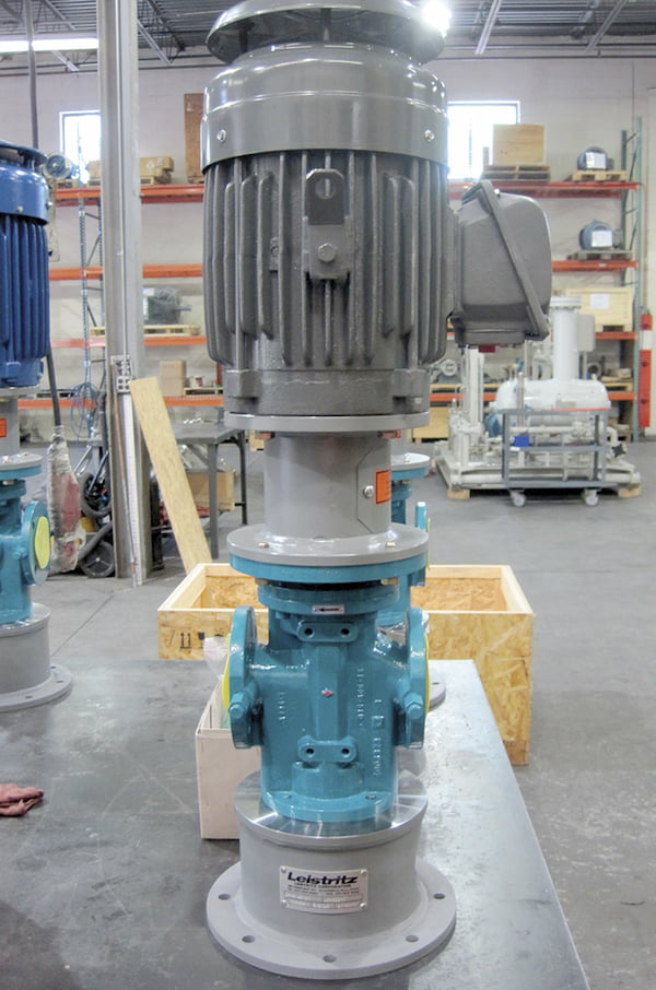

Image 2. Vertical pedestal-mounted pump/motorImage 2. Vertical pedestal-mounted pump/motor
