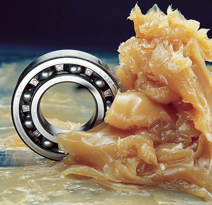

Where feasible, grease is a preferred bearing lubricantImage 1. Where feasible, grease is a preferred bearing lubricant, because grease is easy to apply, can be retained within a bearing’s housing and improves sealing against contaminants. (Images courtesy of SKF)

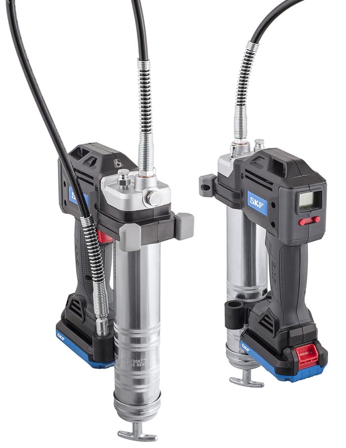

As one of the many handheld tools appropriate for manually lubricating bearings, rechargeable battery–driven grease guns offer portability, consistent performance and user-friendly interfaces to maximize efficiency and accuracy. With such a tool, lubricant flow rates can be precisely adjusted and an integrated grease meter will dispense the proper amount of lubricant to prevent possible over- or under-greasing. A visual display further assists users by showing battery charge level, amount of grease dispensed and blocked lubrication points.

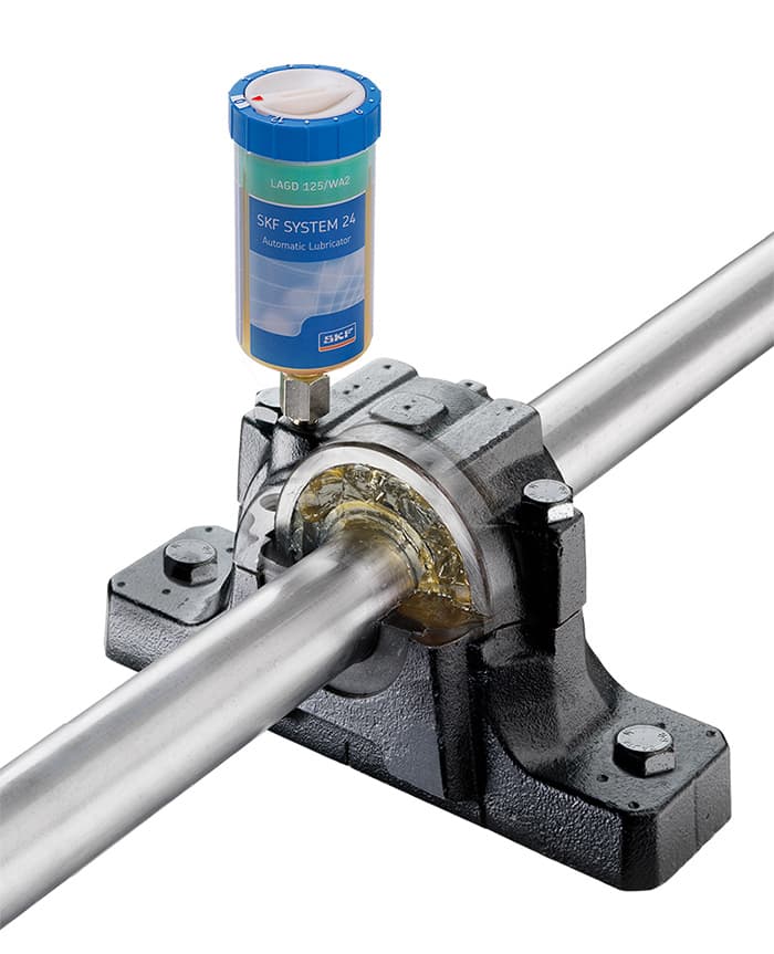

Singe Point LubricatorImage 2. The family of automatic lubrication technologies for bearings includes single-point lubricators to precisely deliver the correct amounts of contaminant-free grease to lubrication points.
Where manual lubrication does not make sense, “hands-free” lubricating technologies offer viable alternatives, depending upon the size of a machine, type of required lubricant, and number of lubrication points, among other factors.
  • Automatic lubricators. These inject the precise and correct amounts of contaminant-free grease at single or multiple lubrication points. They inherently minimize the risks of over- or under-lubricating and can supply lubricant 24/7 for periods up to a year as governed by a pre-set timer. These lubricators will easily control the amount of grease used in each application.

  • Grease GunImage 3. Where manual lubrication is practical, rechargeable battery–driven grease guns are one of the newer technology options offering portability, accuracy and user-friendly operation.

In addition to guiding how and when lubricant can best be supplied, application parameters will similarly help in selecting grease or oil. Such parameters include the type of machine, bearing type and size, temperature, load conditions, speed range, operating conditions (such as vibration and horizontal/vertical orientation of the shaft), and external environment. Equipped with this knowledge, users can narrow the choices to arrive at the most appropriate lubricant type and formulation. Grease. When feasible, grease for bearing lubrication is usually the preferred choice, because it is easy to apply, can be retained within a bearing’s housing, and improves sealing against solid or moisture contamination. The relative tradeoffs, which may not be significant for a particular application are that grease offers no cooling capability, increases friction and torque, limits bearing speed, cannot filter contamination and will be difficult to remove from a bearing if required. Lubricating greases consist of mineral or synthetic base oil suspended in a thickener (with the oil accounting for at least 75 percent of the grease volume). Additives may also be introduced to impart characteristics such as protection against wear or corrosion- and friction-reducing properties. By varying base oil viscosities, thickeners and additives, greases can be developed with distinct characteristics to satisfy particular applications and operating conditions. Oil. This category will usually be specified to lubricate rolling bearings when high speeds, high temperatures or lubricant life and cleanliness preclude the use of grease. If heat needs to be removed from the bearing, circulating oil, oil jet, oil mist, oil splash or air-oil lubrication methods should be used. When application conditions permit, the advantages of oil include easy filling and draining, increased bearing speed limit, reduced heat generation, and the capability to filter contaminants. The tradeoffs are that oil systems are relatively expensive, often complex, and potentially require special sealing methods to prevent oil leakages. Mineral oils represent the most common oil lubricants, and rust and oxidation inhibitors are typical additives. Synthetic oils will usually be considered for bearing lubrication in extreme cases, such as very low or very high operating temperatures, or when extended service life is required.
