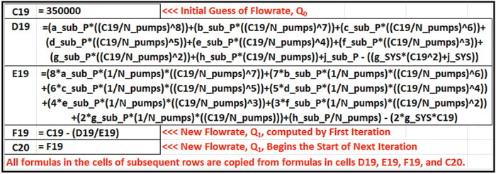

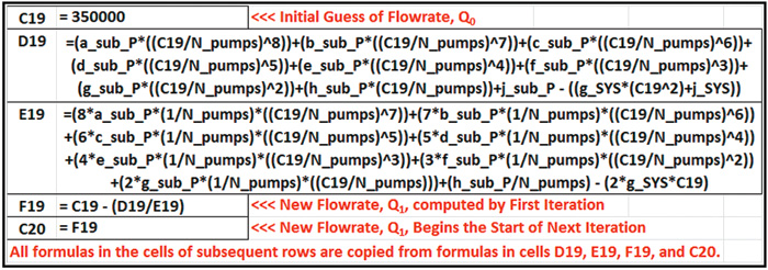

  10. Use iterative numerical methods to solve for head and flow operating points of multiple parallel pumps operating within the specified system. This method uses consecutive rows of spreadsheet calculations to perform successive iterations of the Newton-Raphson method. Results of each iteration eventually converge to the solution of flow rate.

Other numerical techniques can be used for determining the flow rate in Equation 10. For demonstration purposes, set up cell formulas within a spreadsheet to use the Newton-Raphson method. This is an iterative method in which an initial guess at flow rate is made. This initial flow rate is assigned as Q0. The polynomial function (Equation 9) is calculated to determine the head difference at Q0. This head difference is assigned as H0. The slope of the tangent to the head versus flow function is determined by solving Equation 11 for the derivative of ΔHead with respect to flow. In general, the overall slope of the curve in Figure 7 should always be negative in sign throughout its range of operating flow rates. If one extrapolates the tangent line from the (Q0, H0) point on the curve to cross the x-axis, then the flow rate at which the tangent line crosses the x-axis becomes the next guess of flow rate for the next iteration. This flow rate is Q1, and the associated point on the x-axis is (Q1, 0). A tangent line segment runs between two points—Q0, H0 and Q1, 0—and the slope of that line segment is represented by the right-hand side of Equation 12. Evaluation of Equation 11 provides the value of the left-hand side of Equation 12. All the terms—except Q1—in Equation 12 have known values. The terms of this equation can be rearranged to solve for Q1 as shown in Equation 13. Equations 9, 10, 11, 12 and 13 contain all the tools needed to construct a spreadsheet, which can calculate the flow rate through a specified system for a specified number of pumps running in parallel. Table 5 contains a summary of the input parameters, which are used within the cell formulas that are evaluated within the spreadsheet to calculate flow rate by means of the Newton-Raphson iterative method. The summary of calculations shown in Table 6 demonstrates that within five iterations, the successive values of the solution flow rate had converged to within two decimal places. The display of this many decimal places is done solely for the purpose of demonstrating convergence of the solution and does not imply unjustified accuracy of the solution. The use of polynomial curve fits is an approximation. It should also be noted that the number of iterations needed for convergence may vary depending on the closeness of the initial guess to the final solution. The number of iterations can also vary depending on the number of decimal places being considered for the testing convergence. The cell formulas entered into columns D, E and F in Table 6 are based on Equations 9, 11 and 13, respectively. The actual cell formula syntax that can be used in an Excel spreadsheet is summarized in Table 7. Although the initial development of a spreadsheet of this nature can be cumbersome, once it is developed it can provide a useful tool for future pump performance calculations.
