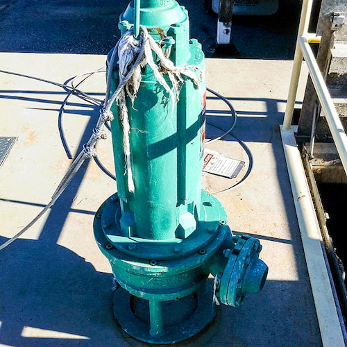

Chopper pumps can be ideal for use in pump stations and lift stations as conditioning pumps. When used as a conditioning pump, a submersible chopper is fitted with a nozzle to provide high-velocity mixing and is placed in the problem wet well on a portable stand.
The purpose of the conditioning pump is to recirculate and chop the contents of the wet well. Recirculating the wet well contents through a chopper pump chops and mixes the grease and debris that can accumulate as a floating layer, and chops and re-suspends heavier debris that can accumulate on the wet well floor.
This homogenization of the wet well contents not only prevents buildup of grease and debris in the wet well, but also helps prevent clogging of the non-clog pumps typically used as dewatering pumps for these stations.
For ORPS, the chopper pump company selected an 8-inch submersible chopper pump with a 25 horsepower (hp), 1,200 rotations per minute (rpm) motor with mixing nozzle and portable stand. In 18 months of use with the conditioning pump, the wet well has not required cleaning. Based on the cost of the pump and installation, the pump paid for itself in just two-and-a-half months of use.
