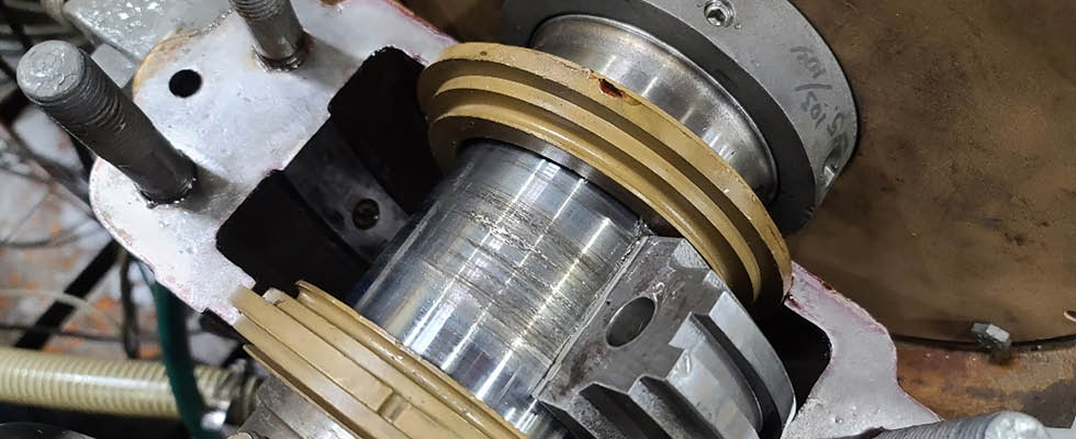

IMAGE 4: Wear on shaft journal at bearing
Because the vibration amplitude was not above shutdown thresholds, the recommendation was to perform a bearing inspection at the next scheduled shutdown. The pump inboard bearing cap was to be removed and the bearing insert rolled out for inspection. If bearing clearances had increased or contact was made with the soft babbitt material of the journal and the pump shaft, there would be physical signs of damage. As expected, when the journal bearing was inspected, it showed signs of wear. The babbitt material had wiped and collected in one area of the bearing. While not catastrophic, it is important to underscore continued operation would have resulted in increasingly worse physical damage and ultimately failure.
