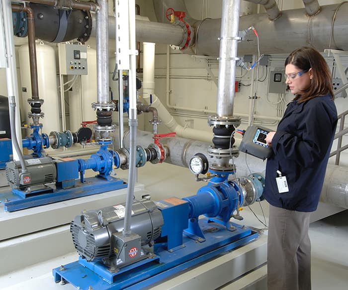

Coriolis. Coriolis meters have a vibrating tube in which a fluid flow causes changes in frequency, phase shift or amplitude. The sensor signal is fed into the integrally mounted pc-board. The resulting output signal is strictly proportional to the real mass flow rate, while thermal mass flow meters depend on the physical properties of the fluid.
Coriolis flow meters directly measure fluid mass over a wide range of temperatures with a high degree of accuracy. Their unobstructed, open flow design is suitable for viscous, non-conductive fluids that are difficult to measure with other technologies. With no internal moving parts, Coriolis meters require minimum attention once installed. However, they are sometimes considered too sophisticated, expensive or unwieldy (see Image 1).

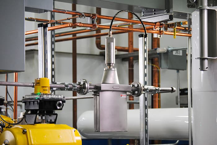

Electromagnetic. Electromagnetic meters use Faraday’s law of electromagnetic induction, whereby voltage is induced when a conductor moves through a magnetic field. The liquid is the conductor, with energized coils outside the flow tube creating the magnetic field. The produced voltage is directly proportional to the flow rate.
Electromagnetic meters will measure virtually any conductive fluid or slurry. They provide low pressure drop, high accuracy, high turndown ratio and excellent repeatability. The meters have no moving parts or flow obstructions, and are relatively unaffected by viscosity, temperature and pressure when correctly specified. Nevertheless, they have a propensity to foul, tend to be heavy in larger sizes and may be prohibitively expensive (see Image 2).
