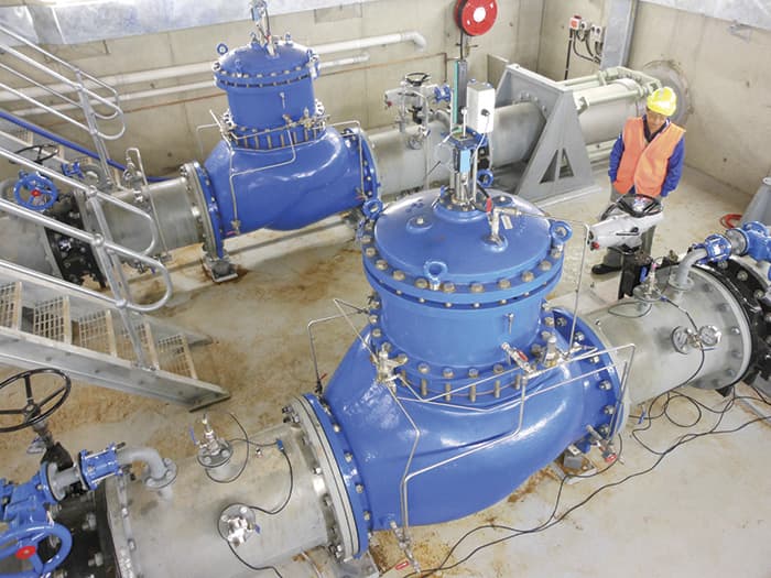

To prepare for these potential failures, a 2-by-24-inch main valve body was installed with two independent diaphragms, allowing for full backup if the primary system fails. The valve will continue to operate normally using a secondary pilot system while alerting operators to schedule maintenance.
Conclusion
By the project’s completion, 23 valves ranging from 600 to 100 millimeters were installed at the ten different stations. Addressing each station’s needs with different pressure-reducing valve accessories—without installing additional equipment to compensate—was key to the project’s success.
According to the project director, the valves have been operating successfully, enabling SA Water to successfully transfer bulk water from the southern reservoirs and the desalination plant to the northern suburbs, securing water supplies to enable growth through to 2050.
