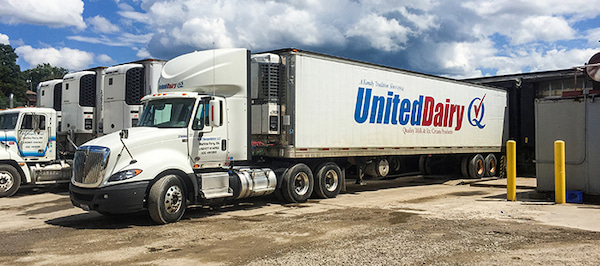

United Dairy bottles milk from family farms located within 100 miles of the plant.Image 1. United Dairy bottles milk from family farms located within 100 miles of the plant. (Images courtesy of BJM Pumps LLC)
