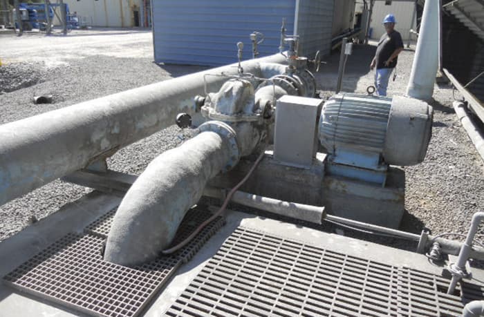

This column discusses the results of an eight-year reliability study conducted at a chemical plant. The plant uses six horizontal split-case cooling water pumps to provide cooling water to the production facility. These six pumps operate in banks of two units, taking suction from three cooling towers and feeding cooling water to three plant processes:
- Crystallizer condenser (Cooling Tower A feeding Pumps A and B)
- Process 3040 (Tower B feeding Pumps C and D)
- Process 5060 (Tower C feeding Pumps E and F)

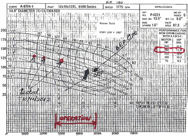

Company management wanted to evaluate the operation of the pumps with regard to their reliability and energy consumption. The eight-year pump reliability study began in 2008 and includes the best economic use of the installed equipment. The pumps are 12x10x12XL model 8100 (11.4-inch impeller diameter), driven by 150-horsepower (hp) motors at 1,775 revolutions per minute (rpm).

As shown in Figure 1, the best efficiency point (BEP) is at 4,800 gallons per minute (gpm) for the 11.4-inch impeller. The actual flow varies from approximately 1,500 to 6,500 gpm, depending on the process demand. As the study showed, Pumps A and B operated, on average, at a higher flow than Pumps C through F.

As shown by the performance curve, the pumps operate within a wide range of flow, sometimes substantially too far to the left of the BEP and sometimes too far to the right. As a result, both cavitation (high flow) and recirculation (low flow) were concerns. The system went online in the 1990s, and the present management inherited the problem and wanted to find the most economical and practical solution.
Both vibration data and flow are plotted as a function of time, as recorded in Figures 2 through 7. The time axis represents each monthly recording.
Pumps are sitting on the ground level, approximately 5 feet above the water supply level, so net positive suction head available (NPSHA) is approximately 29 feet. The performance curve in Figure 1 indicates that the pumps would occasionally run out of net positive suction head required (NPSHR) when operated beyond approximately 5,500 gpm. Among the suggestions for improvement was replacing these split-case pumps with vertical turbine pumps in order to increase NPSHA to more than 40 feet, with an impeller/bell of the vertical pump positioned about 6 feet below the water level. The cost of this change was evaluated against present maintenance.
