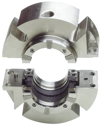

Mechanical seals are also widely used and provide reliable, safe and economical containment of pumped liquids. Different seal types are used depending on the service conditions and fluid character. Component seals—such as the elastomer bellows seal (see Image 1)—are used extensively and have demonstrated excellent reliability in many applications within a treatment plant.
Cartridge, pusher type seals with stationary springs that are installed out of the pumped fluid are effective for handling the abrasive solids and are simple to install and maintain. The seal type or design almost becomes an owner/operator preference.
A solution growing in popularity and preferred during the past decade is the split seal. Some of the equipment found in a treatment plant is very large, creating unique challenges to installing and maintaining the seal. The development of split seal technology has made installation much easier and faster, especially with between bearing horizontal pumps and large pumps. The maintenance of large pumps typically requires special lifting equipment, and replacing a typical seal can take many hours.
Split seals significantly reduce the time needed for installation or replacement and can eliminate the need for special tools or lifting equipment. The bottom line may be a significant reduction in life-cycle cost of the equipment. With split seal technology, seal installation is just like the installation of compression packing, except the leakage is decreased, and the friction on and the wear of the shaft sleeve is eliminated.
