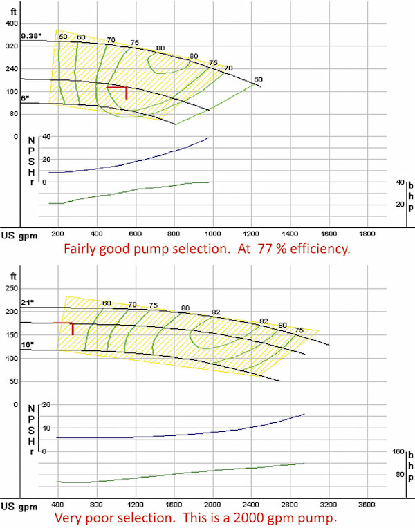

Some pumps may have good efficiency, yet many may surprise you, especially those with changing load conditions or that have new variable speed drives (VSDs). Be careful: VSDs can produce better efficiency and reduce costs, but make sure that your support staff has expertise in electronics and controls.
Not many VSDs will last 30 to 40 years like those induction-motor-driven pumps of yesteryear. In fact, VSDs have life expectancies similar to direct expansion (DX) air-conditioning systems—10 to 12 years at best—not to mention process downtime from harmonics, overheating, control device failure, etc. Pump performance curves and system operating data will be required to conduct a technical assessment (see Figure 1).

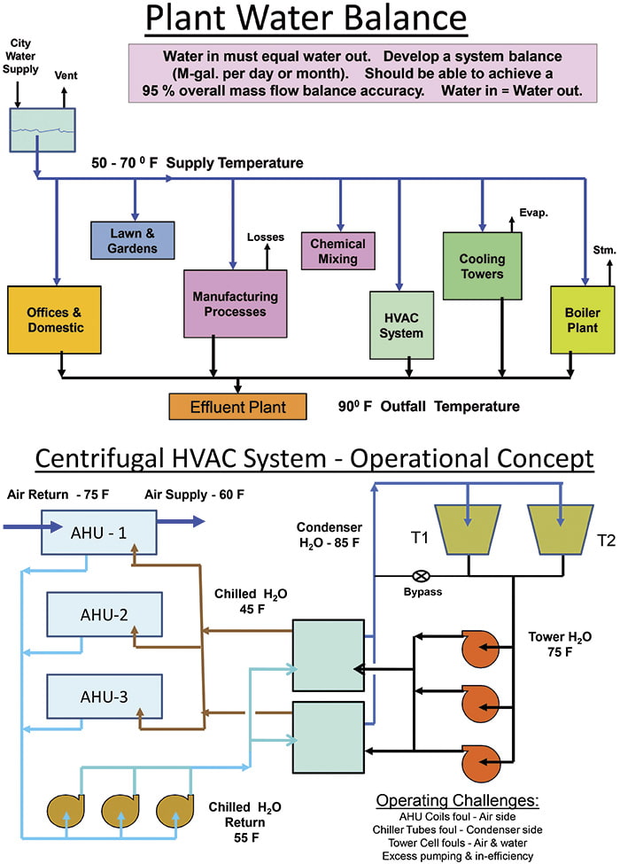

Downsizing engineering and maintenance crews in mature facilities has resulted in less effort on pumping system efficiency improvements. The system schematic in Figure 2 shows an overall plant water system for a typical industrial facility. Every process indicated includes circulating pumps of various types, sizes and vintage.
Centrifugal Air-Conditioning Systems: For larger facilities, centralized centrifugal chiller units are often used for airconditioning (see Figure 3). Universities, hospitals and larger office complexes may also have centrifugal systems.
Generally, this equipment is more robust and has longer life expectancy than packaged DX systems. Also, these systems use many pumps. Closed chilled water loops provide cooling to the air handlers. Open condenser water loops dump the heat to the outdoors.
These water systems may require booster pumps or secondary pump loops. The load varies significantly from summer to winter and day to night. Pumps can vary in size, number and speed to accommodate the changing load; however, system efficiency (pumping power) may be a low priority as compared with effective control of the ambient conditions.
