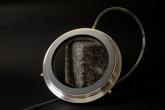

This article will describe a new or unconventional way to balance the contact forces of the dynamic seal faces by enabling an opening force rather than the conventional way of balancing the closing force, as described above. It does not eliminate the requisite closing force but gives the pump designer and user another knob to turn by allowing unweighting or unloading of the seal faces. It maintains the needed closing force, thus reducing heat and wear while widening the possible operating conditions.

In the case of externally pressurized porous bearings, the bearing will be in a balanced force mode when input pressure times the area equals the total load on the bearing. This is an interesting tribological case as there is zero lift or air gap. There will be zero flow, but the hydrostatic force of the air pressure against the counter surface under the face of the bearing still unweights the total load and results in a near zero coefficient of friction—even though the faces are still in contact.
For example, if a graphite seal face has an area of 10 square inches and 1,000 pounds of closing force and the graphite has a coefficient of friction of 0.1, it would require 100 pounds of force to initiate motion. But, with an external pressure source of 100 psi ported through the porous graphite to its face, there would be essentially zero force required to initiate motion.
This is despite the fact that there is still 1,000 pounds of closing force squeezing the two faces together and that the faces are in physical contact with each other.
Bearing Materials
A class of plain bearing materials—such as graphite, carbons and ceramics such as alumina and silicon-carbides that are known in the turbo industries and are naturally porous—can be used as externally pressurized bearings. These provide noncontacting fluid film bearings.
There is a hybrid function where external pressure is used to unweight the contact pressure or the closing force of the seal from the tribology that is going on in the contacting seal faces.
This allows the pump operator something to adjust outside of the pump to deal with problem applications and higher speed operations while using mechanical seals.
