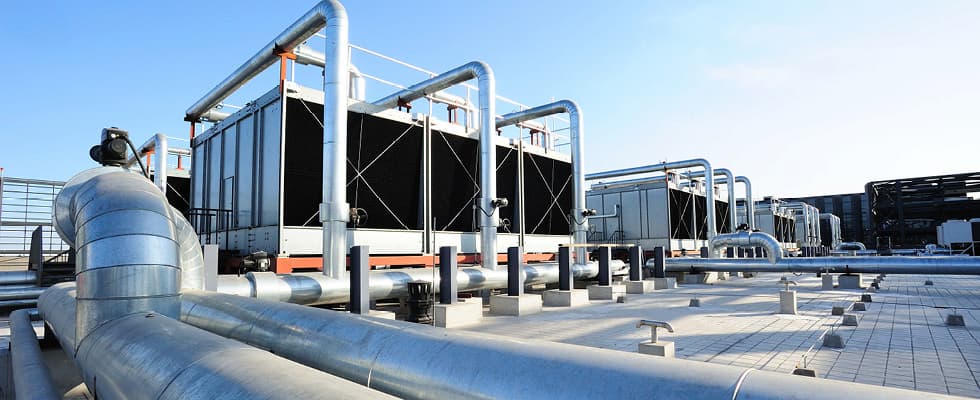

Cooling towers are some of the most cost-effective cooling systems today. They remove unwanted heat from water by bringing cool air and warm water into contact, transferring or rejecting the heat via evaporation.
Wet and dry cooling towers differ in how they remove heat. Most cooling towers are wet, while air-cooled heat exchangers are dry. However, both designs use an axial fan to move air inside the tower, feature a covering to contain the fan and funnel the air into the fan and have plenums (specific spaces) to direct the air, allowing the heat to be transferred by direct or indirect contact.
Cooling towers are categorized as either crossflow or counterflow towers. In crossflow towers, the water and the air move almost perpendicular to each other, while in counterflow towers, the water and air move in opposite directions. In addition, cooling towers can be classified as induced-draft or forced-draft towers. In induced-draft towers, the fan, commonly at the top of the tower, pulls the air through the tower’s fills. Conversely, in forced-draft towers, the air is pushed toward the fill media from the tower’s base.
