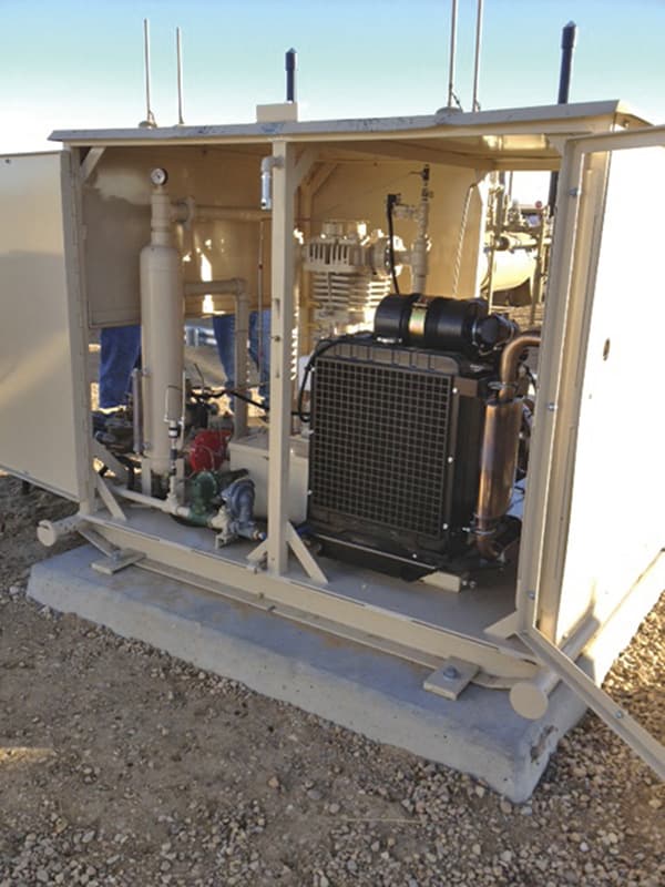

The Solution
Recognizing the untapped potential for an improved vapor-recovery technology in the oilfield, a Michigan pump manufacturer provides compressor products that cover a broad range of markets, including oilfield vapor-recovery applications.
Several of the pump manufacturer’s series of oil-free reciprocating gas compressors were designed to handle hazardous, toxic or flammable gases. Their oil-free design provides unique features that were once considered unnecessary and unimportant in the natural gas market. These features have strong environmental appeal while offering the best vapor-recovery mechanics and sealing technology. The benefits of these features include:
- Oil-free designs do not add additional contamination to the gas being handled or recovered.
- Maximum control of gas leakage from the compressor is achieved because of the compressor’s full distance-piece compartment and piston-rod seals. The two sets of rod seals create a compartment between the process gas and the lubricated crankcase, which provides leakage control and minimizes any leakage to the crankcase or the atmosphere.
- The ductile-iron construction of all pressure parts results in greater resistance to harmful thermal and mechanical shock.
- High-efficiency valves made of polyether ether ketone are self-lubricating and provide high-quality sealing characteristics and durability.
- A heavy-duty, precision-ground crankshaft features roller bearings and integral counterweights to ensure smooth, quiet operation.
These design advances make these compressors environmentally friendly and a safe method to move and recover gas vapors. In highly regulated tank vapor-recovery applications, these important features help deliver peace of mind to the oilfield operator and producer.
The distance-piece design feature of the oil-free reciprocating gas compressors is critical because condensate can form inside the compressor because of the wide mix of hydrocarbons that can often be found in the gas stream.
Formation of condensate inside the compressor is never good. When the gas is compressed, heavier hydrocarbons and small amounts of water vapor can form. Compressors that do not have a distance piece allow the condensate to leak directly into the crankcase. It can damage the quality of the lubricating oil and lead to significant bearing damage or a complete failure of the power frame.
The oil-free reciprocating gas compressors help control condensate that may form. Their design helps control small amounts of condensate by collecting it in the distance-piece compartment.
Easy operator access to this compartment allows the end user to empty it regularly. The distance piece can also be vented to a safe disposal area when available. While single-compartment, distance-piece designs will generally satisfy most design requirements, the pump manufacturer also provides triple-packed (two-compartment distance-piece) models for applications in which leakage control is extremely critical. These designs have been used in industrial and chemical plant applications for many years.
Single-stage models, which are recommended for use on low-to-moderate compression-ratio applications, are available in seven sizes with piston displacements up to 125 cubic feet per minute (212 cubic meters per hour) at working pressures up to 1,000 psia (69 bara). The three, two-stage models, which are available for higher compression-ratio requirements, provide piston displacement up to 53.7 cubic feet per minute (91.2 cubic meters per hour) at a working pressure up to 615 psia (42.4 bara).
