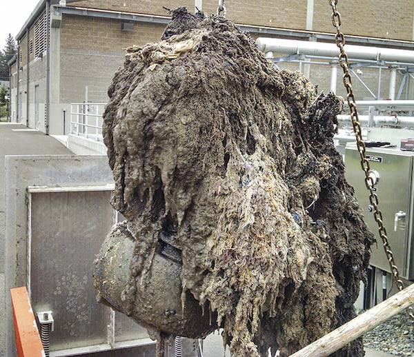

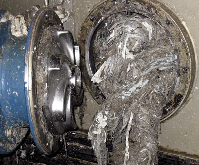

Disposable wipes and other non-dispersible products are a modern-day curse for older wastewater lift stations and pumps that move sewage through collection networks. Lift station pumps are designed to handle traditional wastewater solids, with some handling spherical solids up to 3 inches in diameter—about the size of a baseball.
The problem created by non-dispersing wipes and rags is that they form into large rag balls in collection systems, or they form mats on the fluid surface of wet wells. The issue is amplified when these wipes combine with fats, oils and grease (FOG), as well as hair, in the sewage to become indestructible masses of solids.

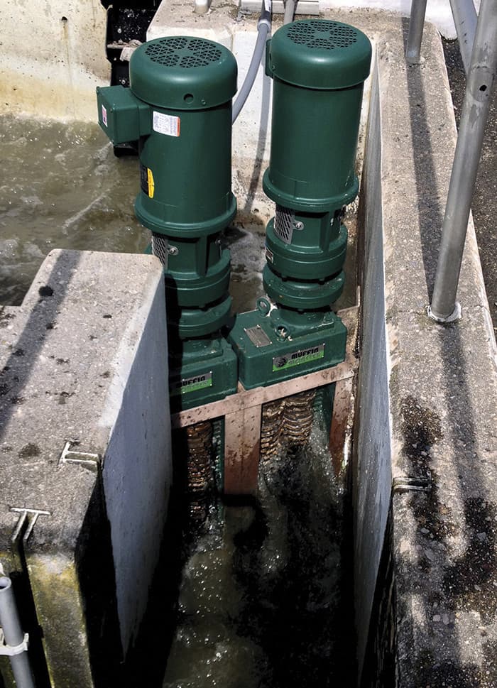

In many cases, dual-shafted grinders have kept the plague of flushed wipes under control. With their low-speed and high-torque design, grinders have been used for years in collection systems to shred tougher solids such as wood, rocks or other debris that can find their way into sewer networks and cause clogs. Many engineers and operators are using grinders to combat the introduction of wipes into wastewater and keep pump stations working as designed.
In the fight against wipes, grinders can be a cost-effective alternative to upgrading older wastewater lift stations. Pump upgrades meant to deal with wipes can be a costly proposition with new electrical requirements, hydraulic considerations and potentially lower efficiency. Plus, some pumps may not be able to handle tougher solids such as rocks or larger rag balls that can be shredded by a high-torque grinder. While conventional grinders cut products into longer strips that can reweave with FOG and hair, some newer grinders have cutters that will cross-cut the wipes and stringy material in two directions, making the debris small enough to remain pumpable.

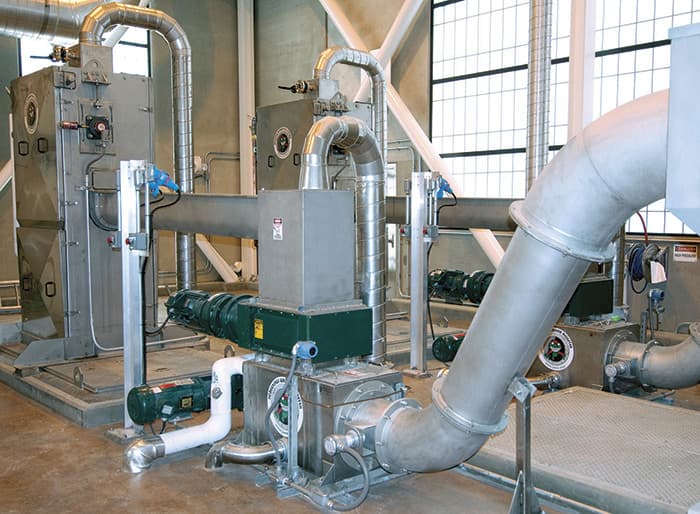

An automated fine-screening solution is one upgrade to keep disposable wipes out of WRRFs. Fine screens are designed with two directional screening panels typically made from perforated stainless steel or high-strength plastics. The two directional fine screens using 6-millimeter-or-less hole sizes remove smaller pieces of trash, such as rags, wipes, cotton swabs, plastics and latex that can easily pass through traditional bar screens.
In-to-out fine screen layouts such as band screens or drum screens offer effective capture of solids because of their non-carry-over design, which is better equipped to protect downstream high-tech treatment equipment such as membrane bioreactors (MBRs). MBR manufacturers frequently recommend a band screen or drum screen with 1- to 2-millimeter perforations to prevent small trash and hair from fouling the membranes’ pores.

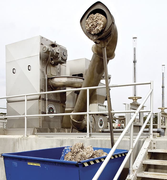

One major consideration with fine screens is that the smaller openings will achieve much higher capture rates than earlier generations of headworks screens. This means they will discharge more screenings with higher fecal content than typical bar screens—sometimes twice as much. This makes screening management key.
Innovative screenings washer compactor solutions have been developed that wash, dewater and reduce excess debris for landfill disposal. Some of the most effective washer compactors have integrated equipment that shred and precondition the screenings for washing and compacting.
The result is maximum fecal removal and a much drier and compacted end product, as well as a reduction in odor and overall loads of screening waste.
