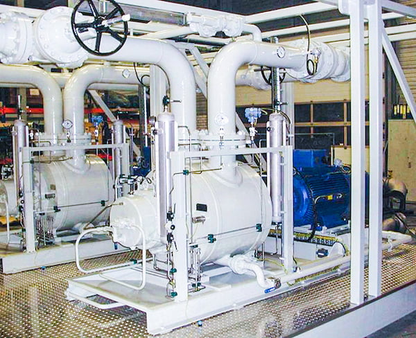

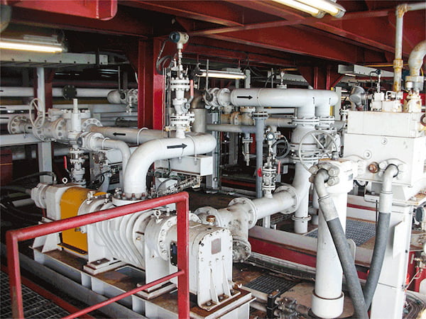

As a volumetric fluid handling technology, two- and three-screw rotary positive displacement pumps create flow and are insensitive to system pressure changes. They deliver a nearly constant volume of liquid over a range of discharge pressures. This is why two- and three-screw pumps are often the pump technology of choice for demanding hydrocarbon applications where flow or pressure demands change frequently, or even occasionally, on any given day.
In designing a positive displacement pump for this application, one of the most important, but commonly overlooked, data inputs from users is detailed characteristics of their process fluid. Whether the specific fluid properties are proprietary, variable or just not known, this information must be determined and relayed to the manufacturer to ensure provision of a pump that will perform as desired in the specific application.
