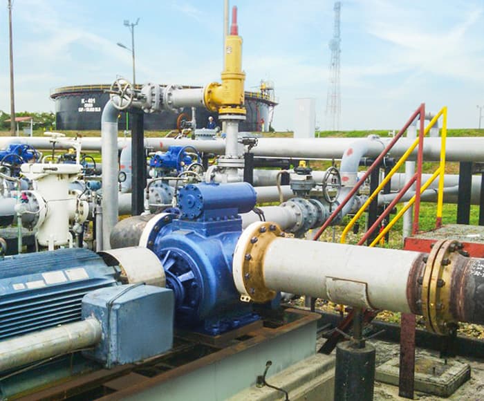

In chemical processing, unit operations are the blueprint for a series of production stages.Image 1. In chemical processing, unit operations are the blueprint for a series of production stages. One of these stages is a series of fluid-flow processes that consists of transfer, filtration, solids fluidization and transportation activities. Screw pumps, which are available in twin- and triple-screw configurations, have exhibited the capability to perform reliably, efficiently and safely in these critical applications. (Images courtesy of Blackmer)

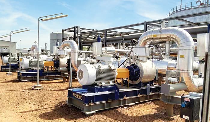

Screw pumps can easily transfer fluids of varying temperatures and viscosities.Image 2. While the chemical-processing industry has long relied on centrifugal pumps for fluid-handling activities, screw pumps can easily transfer fluids of varying temperatures and viscosities. This means that there is no need for the operator to have to manipulate the fluid-transfer process in order to fit the needs of the pump, which can be time-consuming and costly.
