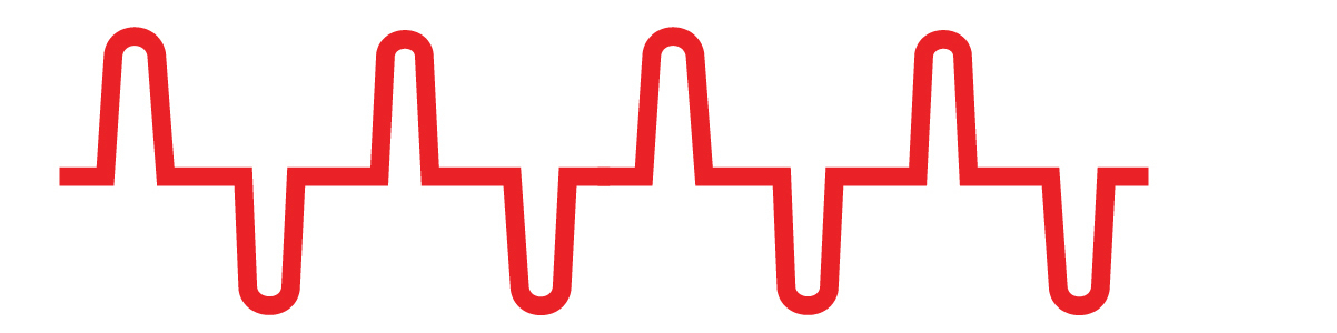

An ordinary variable frequency drive (VFD) generates harmonics at both its input and its output. On the motor (output) side, the VFD emulates a sine wave with a pulse width modulated (PWM) signal. The difference between the two signals is shown in Image 1. The PWM signal is somewhere between a square wave and a pure sinusoid. The squared-off nature of the PWM signal results from the limited switching frequency of the integrated gate bipolar transistors (IGBT), commonly used in ordinary VFDs. Harmonics are an inevitable and unfortunate by-product of a PWM signal.
Sine Wave
IMAGE 1: Sine wave vs. PWM signal (Images courtesy of SmartD)
