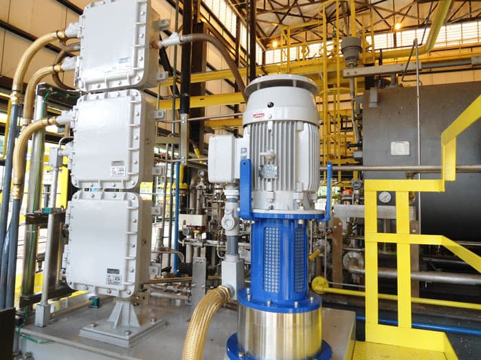

The operator found a seal gas booster, which requires virtually no maintenance, making it ideal for remotely operated compressors. These rotating seal gas boosters use a magnetic coupling to drive the rotating component, eliminating the need for a seal. The hermetically sealed unit eliminates leakage to prevent any climate-damaging methane from escaping into the atmosphere, making it an ideal choice for the rainforest. The operating principle was also simple, requiring no high demand of air utilities to operate. Only minimal air and power was required for implementation.
With the high efficiency design of the magnetic coupling, which produces 98 percent less eddy current than a conventional magnetic coupling, the power consumption loss associated with torque transfer through the pressure barrier is dramatically reduced. These features made it the ideal seal gas booster to use for this application.
Seal gas booster installedImage 3. Seal gas booster installed at site

Four seal gas booster systems were procured for this project. The engineering, manufacturing of the seal gas booster skids and site installation were all undertaken by the seal gas booster supplier. The systems consisted of the rotating seal gas booster, filters, pressure transmitters, flow transmitters, valves and a frequency converter. All components were connected to a programmable logic controller (PLC) to provide remote operation and monitoring for the systems. The electronic control of the seal gas booster optimized seal gas flow so just the right amount was provided to deliver the highest seal reliability with the most efficiency.
From the June 2013 installation and commissioning of the systems, the seal gas booster systems have been running smoothly without maintenance requirements.
