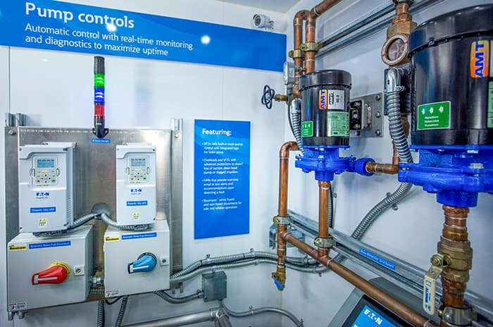

Inherent technology in variable frequency drives (VFDs) can enable these benefits. The multipump function onboard VFDs is used in process applications where multiple pumps maintain pressure or flow. A single proportional integral derivative (PID) controller loop in the VFD is used to maintain a process set point, like a fixed frequency reference. If a single pump is not able to meet the demand, additional pumps are used to boost the system. There are two basic types of multipump control: single drive and multiple drive.
Multipump control with a single drive uses one drive with one motor and controls up to four more motors running across the line. Multipump control with multiple drives uses one drive per motor through a master/slave control platform with a total of five drives. In both scenarios, the VFD uses the onboard PID loop to execute the logic controls based on the fixed frequency reference.
Cost Savings
System cost can be reduced when the VFD’s onboard multipump control is used. The PID capabilities inherent to the drive eliminate the need for an external programmable logic controller (PLC) to execute the logic. By removing the PLC from the control system, cost savings result from fewer requirements of equipment, labor and engineering.
pump controlsImage 1. Multiple pump controls. (Images courtesy of Eaton)
