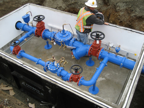

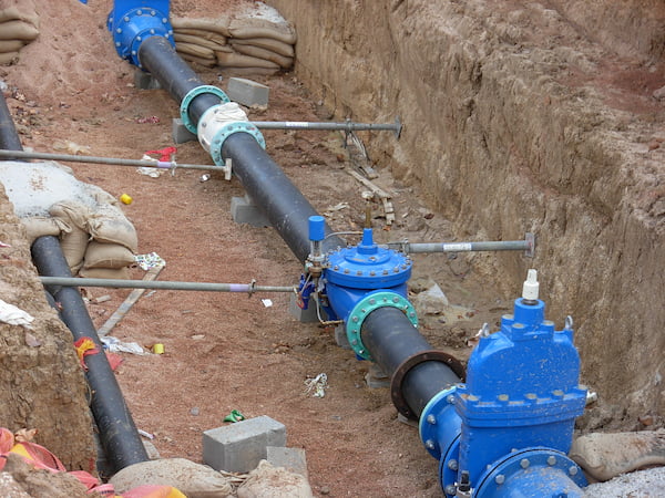

Location & Installation
Pilot valves require maintenance, adjustments and electrical connections. Therefore, easy access is important. They cannot be direct buried like gate valves. Typically, they are mounted in valve boxes or underground valve stations in colder climates and above ground where freezing is not a concern.
The valves should be mounted with the stems in a vertical position. They will work in any position, but for practical purposes, install them in a horizontal line, with the stems vertical. This makes future maintenance much easier. Second, leave plenty of space around the valve for future maintenance and access.
Maintaining straight runs before and after the valve is best during installation. The inlet side of the valve is not as critical as the outlet side. A butterfly valve should ideally never be mounted against the valve as this will direct flow in an uneven path into or out of the valve. This is not as critical with gate valves.
The outlet side of the valve is a different matter. Ideally, there should always be a few pipe diameters downstream of the valve to assist in settling the flow after the turbulence of the control valve.

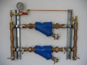

A straightforward and effective way to prolong the cleaning cycle is to use a simple duplex strainer assembly. This could be as simple as installing the valve with two strainers, which can be manually switched to ensure uninterrupted valve operation while the first strainer is being cleaned.
A better method is to install a dedicated, wall-mounted strainer system. This is particularly useful if a valve chamber has more than one valve. The concept is to oversize the strainers used from a simple 9.5-millimeter inlet to that of a 40-millimeter inlet.
This greatly increases the surface area of the screen and allows for much longer run times, requiring a lot less maintenance. Typically, strainers are supplied at 40 mesh, but they can be 60 or 80 mesh, depending upon the requirements.
Note that each strainer can run at any given time and that a differential pressure gauge can be plumbed across the strainers to indicate when each strainer requires cleaning. This can be determined with time with each application.

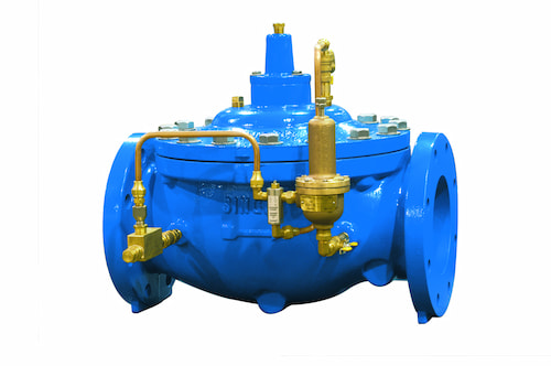

How does the pilot actually sense the pressure downstream to accurately detect what it needs to do to control the pressure? Looking at how a typical pressure reducing pilot valve is installed on the valve, can show how this is achieved. Note in Figure 1 how the reducing pilot is connected to the downstream side of the control valve.
Examine the pilot itself in Figure 2. Internally, the downstream chamber is exposed to downstream pressure (light blue section), and this area interacts with a spring by way of a diaphragm in the pilot.
If the pressure in the downstream zone is greater than the spring setting, it forces the diaphragm upward and carries the inner valve yolk assembly, closing off the flow from the inlet to the outlet of the pilot. As the pressure in the downstream zone falls, the spring force is now greater than the pressure, so the spring forces the inner valve stem downward, opening the flow from the inlet to the outlet of the pilot, which opens the main valve.
Therefore, this effective diaphragm area and the accurate sensing are key to getting a stable pressure downstream. With that in mind, having this pilot directly connected to the body tapping on the downstream side of the main valve is not ideal.
Outlet body tappings of control valves typically fall into a distance range of 0.5 to 0.75 pipe diameters downstream of the valve seat. This means that the typical pilot senses turbulent water as it leaves the valve’s seat and is not considered laminar flow.

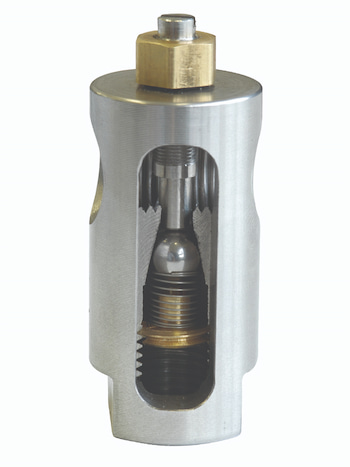

Conventional thinking for small flow regulation suggests that a needle valve would be ideal. Unfortunately, that is what is most commonly used in some variation. The key issues with any type of needle valve are plugging and wear over time. Because the orifices are small, they are prone to fouling and susceptible to growth in the same way that the main valve stem is. Wearing over time also means that the valve does need occasional readjustment to maintain the same opening characteristics as during initial commissioning.
A simple and innovative design is shown in Figure 3. The internals are tapered, but there is not an actual needle. The restricting action is formed by limiting the travel of a stainless steel ball along the tapered channel. The ball constantly rotates, so it is self-cleaning, making it a set-and-forget speed control. It allows free flow into the bonnet and adjustable flow out.
