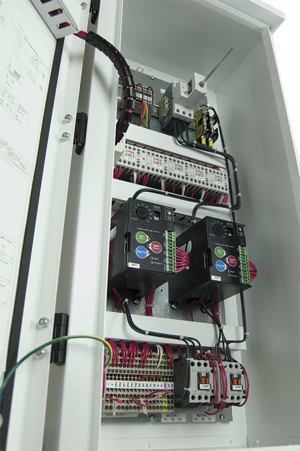

Some manufacturers may package two drives together in one enclosure, often referred to as a duplex lead-lag drive package. These packages are specifically designed to meet Underwriters Laboratories UL-508 requirements. The programming of the drives is one advantage of ordering a lead-lag drive package from a manufacturer. The ordering process also may allow for discussion about the applications for which the drives will be used. This enables the firmware on the drives to be preprogrammed precisely for the specific application.
In some cases, an application may call for lead-lag alternation. Alternating the lead and lag pumps can greatly increase the life of a system. Because more than one pump is doing the work, pumps will wear evenly.
A lead-lag alternating drive package will usually provide different alternating modes (such as fault alternation) and lead-lag control based on input signals from pressure transducers and the VFDs status outputs. Adding alternation to a duplex
lead-lag drive package will increase the cost of the unit, but, in many cases, it is a worthwhile and necessary option.
Some manufacturers provide starter packages designed for lead-lag applications. This option can be less expensive than a drive package, at least in upfront costs. In lower horsepower applications (about 10 horsepower or lower depending on location and application), soft starting capabilities are not generally necessary, and the energy savings derived from VFDs diminish at lower horsepowers. For this reason, starters can be a good option in low- to moderate-horsepower lead-lag applications that do not require varying motor speeds, such as the emptying or filling of a reservoir.
