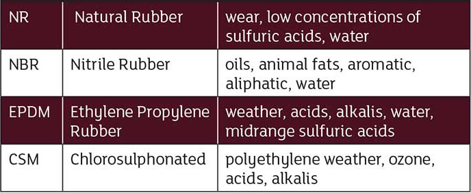

In some cases, the medium is mixed with multiple chemicals and it may be difficult to determine the best rubber hose type for the application. Trying to overanalyze the best hose material can be a waste of time. In a large number of instances, the chemical fractions are minor and will have little impact on the rubber over time.
If it is necessary to be absolutely positive on the best alternative, then rubber coupons can be submerged in the chemical compound and checked for swelling and weight gain. This may take time, but it is probably the best manner to gain the most confidence.
In general, certain rubber materials are better for certain compounds. Here are some of the basics.

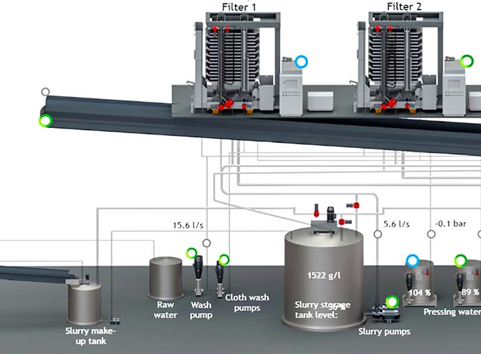

pressure filtersImage 3. IIoT monitoring and analysis of a filter plant. All three of these pressure filters have been equipped with smart cubes. By monitoring this filter operation the machines can be optimized for increased production. Monitoring of key wear areas can provide early detection of wear and tear and alarms are triggered to allow maintenance to repair minor issues, avoiding costly repairs and process downtime.

rubber hoseTable 1. Rubber hose materials and uses
IIoT Monitoring of Pumps & Other Assets
The industrial internet of things (IIoT) monitoring of pumps can add benefits for the user. For instance, two brands of pumps working in the same application can be analyzed side by side with real-time performance data that is tailored to the user to prove the best performer.
IIoT monitoring can be created with a digital twin visual environment that allows users to fully understand which pump has less downtime, lower costs and fastest repair time.
Virtually any critical asset with digital or analog instrumentation can be monitored in this manner. IIoT monitoring allows the digital twin imagery to be created and customized for various users. IIoT monitoring may be combined with an embedded document management system where all drawings, manuals, repair videos, spare parts and just about anything needed can be found at a moment’s notice on a smartphone, tablet or personal computer with an internet connection.
In many chemical process facilities, a maintenance technician may have to visit seven or eight systems to capture information. Each system may have different usernames and passwords. The technician may invest four to eight hours of research before any real work can begin.
With IIoT monitoring and embedded document management, the technician has an immense amount of information at their fingertips.
The technician does not even need to call the control room to find information such as pump speed, amp draw, inlet and outlet pressure and other data. It is all at their disposal through their smartphone, tablet or computer.
With IIoT monitoring, speed to repair is improved, less catastrophic downtime is incurred and maintenance costs can be significantly reduced.
