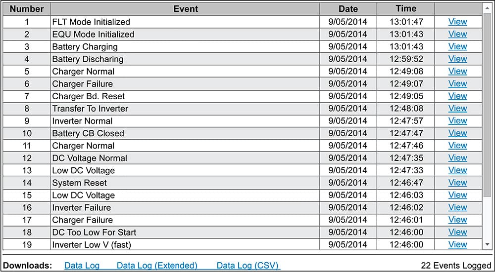

When a power outage or severe power quality deterioration occurs, pipelines and pumping systems must enter into safe network shutdown procedures. These protocols are controlled by various servers that monitor and control the system parameters; however, incidents take place when the systems do not operate correctly, even when the predetermined power-down protocols were followed. These malfunctions occur when the UPS batteries are drained of power, triggering a power loss in the backup batteries that causes failures in many, if not all, of the control systems deployed at a pumping station or pipeline control mechanism. These malfunctions are unacceptable since improper sequencing of pump valve shutdown protocols can lead to huge problems, including auto-shutdown valves failing to activate and, in the worst case, ruptured lines. The latest UPS technology guards against these malfunctions, ensuring that the servers send the proper shutdown communications prior to and after a power loss. The newest software built into UPS systems more accurately monitors remaining battery life and controls server shutdown protocols based on real information of true battery life. It can provide the information needed to prevent system errors that cause the servers to lose power before commencing a shutdown of the pump systems.
Figure 2. A data log gives UPS users the ability to check the status of the batteries, charger and inverter as well as other system parameters.
