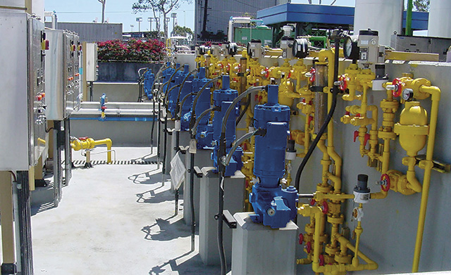

Metering Pump Installation
When designing a pumping system, users must consider any existing location or environmental concerns. Keep in mind that metering pumps are able to "push" against high pressures but will struggle to "pull" over longer distances. This means that suction lift should be limited to no more than 4 feet and that a foot valve should be used in top-mount installations. Flooded suction is always preferred in a metering pump installation to ensure the pump is easier to prime, but the length of the flooded suction should be limited to 6 or 7 feet. Other components of the installation to consider include:- Suction piping. The traditional rule of thumb is to use pipe that is one size larger than the pump's suction connection, though using pipe that is the same size as the suction connection is acceptable, if the metering pump will be operating at a slow speed when transferring low-viscosity chemicals. Generally, do not use hard piping that is smaller than 3/4-inch in diameter or that is smaller than 3/8 inch in diameter for low-flow applications that use plastic tubing.
- Discharge piping. The size of discharge pipe is not as critical as that of the suction pipe, but the piping must be suitable for the discharge pressure. Typically, matching the pipe size to the discharge connection should be sufficient.
- Suction strainer. A suction strainer should always be used, because it prevents foreign matter from entering the pump's ball checks.
- Flanges/unions/compression fittings. At least one of these fittings must be installed at the suction and discharge ports to facilitate maintenance procedures.
- Isolation valves. Large-port, quick-opening isolation valves should be placed at both the suction and discharge ends of the installation as a way to ease maintenance operations. Needle valves should not be used because their design will create flow restriction.
- Calibration column. Because metering pumps often feature pulsed flow at low volumes, a draw-down calibration column is the most accurate and convenient method to measure pump performance. A tall, thin column should be used to ensure ease of reading and reporting accuracy. Calibration columns can also be helpful in determining if any wear has occurred or dirt has accumulated in the pump's check valves. If the liquid in the column "bounces," that may indicate that the valves are worn or dirty.
- Relief valve. Though the metering pump may be constructed with an internal relief valve, users should consider installing an external relief valve. It should be set at 50 psi (3.5 bar) or 10 percent above the maximum operating pressure, whichever is greater. Any chemical that flows through the relief valve is piped back to the feed tank. Using transparent tubing for the relief valve will allow the operator to observe any returned fluid and identify any impurities. When piping the relief valve's return to the suction side of the installation, the return must be upstream of the pump's isolation valve so that the flow rate will not become blocked.
- Back-pressure valve. This component is only necessary when the installation does not produce adequate back pressure and the pump does not contain a built-in back-pressure device. Back-pressure valves are also required when a system has a low-pressure injection point that is hydraulically lower than the feed tank.
- Pressure gauge. The pressure gauge should be sized 30 to 50 percent larger than the maximum expected pressure that is produced by the system.
- Pulsation dampener. Pulsation dampeners are most commonly required in systems that feature long discharge lines where fluid acceleration can adversely affect the pump's maximum pressure capacity or relief valve setting. The pulsation dampener will minimize the pressure spikes that these acceleration circumstances may cause.
- Injection quills/check valves. An injection quill that is installed at the pump's injection point will serve as a check valve while providing better dispersion of the chemical. In low-pressure applications, an injection quill that incorporates a corporation stop, which allows the injection quill to be inserted or removed without having to drain or shutdown the system, will improve efficiency and overall performance.
