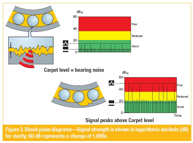

Shock Pulses occur during bearing operation when a rolling element passes over an irregularity in the surface of the bearing race. Of course, there is no such thing as a perfectly smooth surface in real life. Therefore, even new bearings emit a signal of weak Shock Pulses in rapid succession. This Carpet Value rises when the lubrication film between rolling elements and their races becomes depleted.
A defect on the surface of a rolling element or bearing race produces a strong Shock Pulse reaction with up to 1,000 times the intensity of the Carpet Value. These clusters of high amplitude peaks or Maximum Value stand out clearly from the background noise and are ideal indicators of bearing damage.

Two normalized parameters are used to determine bearing condition:
  • Carpet Value—Indicates deterioration or a poor lubrication condition. This can be caused by a number of conditions such as insufficient lubrication, lubrication contamination, shaft misalignment, improper bearing load or improper bearing installation.
  • Maximum Value—Indicates damaged bearing elements. Maximum Value is generated by clusters of higher amplitude Shock Pulses. This is caused when the bearing elements hit defects within the bearing such as a spall on a bearing raceway.
Maximum Value will always be greater than Carpet Value. Carpet and Maximum Values will increase in amplitude by roughly the same amount if lubrication breaks down. If bearing defects are present then Maximum Value will increase or trend upward faster than Carpet Value, and the separation between the two will increase. To keep things simple, Carpet Value normally indicates lubrication condition, and Maximum Value most often relates to bearing damage.
