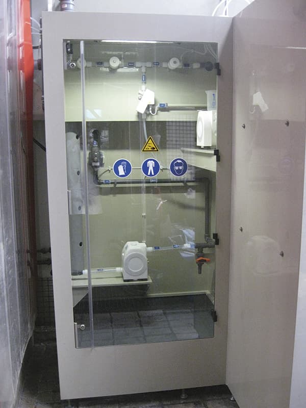

Image 1. The need to use hazardous or dangerous chemicals in the manufacture of numerous products or the completion of a wide array of industrial processes is a fact of life. (Images courtesy of Almatec)Image 1. The need to use hazardous or dangerous chemicals in the manufacture of numerous products or the completion of a wide array of industrial processes is a fact of life. (Images courtesy of Almatec)
Positive displacement (PD) plastic solid-body air-operated double-diaphragm (AODD) pumps have the design and construction features necessary to guarantee full containment of dangerous chemicals without sacrificing high levels of operational efficiency.
