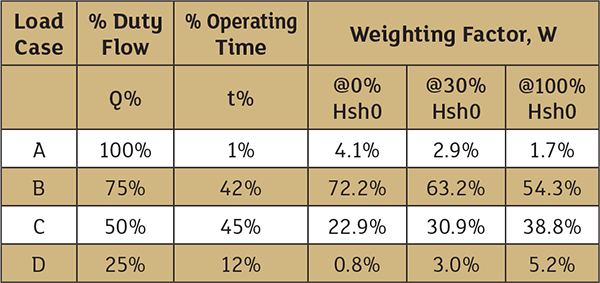

Using the original time weighted factors in the PLEV formula, new sets of weighting factors emerge. Table 1 compares three different sets of weighting factors, or W. Each is based on a system curve passing through a static head value at zero flow (designated as Hsh0).
Table 1Table 1. TWE weighting factors for load cases A, B, C and D
  • at 0 percent static head (0 percent Hsh0) - a friction driven system curve with a zero-static head
  • at 30 percent static head (30 percent Hsh0) - a typical system curve including a static head of 30 percent of the duty head plus a friction component
  • at 100 percent static head (100 percent Hsh0) - a constant pressure system curve with the static head and all operating conditions equal to 100 percent of the duty head
Figure 1Figure 1. Variable speed pump performance intersecting system curves with static head of 0 percent, 30 percent, 60 percent and 100 percent of duty point head (Images courtesy of Intelliquip)
The weighting factors in the TWE formula differ from PLEV. The W factors are affected by both time and power, and change based on the static head for each system curve.
