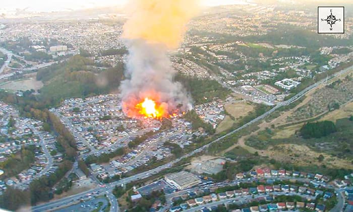

On September 9, 2010, a 30-inch diameter natural gas pipeline ruptured in San Bruno California causing a massive fire that killed eight people. The accident released 47.6 million cubic feet of natural gas and also destroyed 38 homes in the residential area (see Image 1). Many small missteps occurred that resulted in this accident and caused loss of life. One misstep that does not get much attention is packing friction that created problems with control valves. The pipeline pressure experienced extreme oscillations, resulting in the pressure levels in the pipe that exceeded the limits the pipe could safely contain.
On the afternoon of the explosion, an employee was working on the electrical distribution system by replacing the uninterruptible power supply (UPS) that powered some data acquisition equipment and the control valve electronics. Something happened that interrupted any signal and power to the control valves; it caused the main control valve to fail in the open position. The remaining online analog control valve had to handle the entire load, and this caused extreme pressure cycling.
