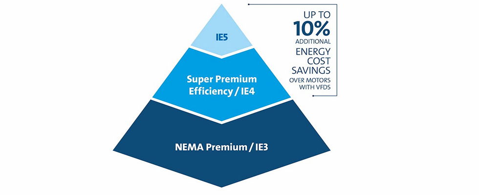

NEMA PremiumImage 1. Cost savings on NEMA Premium motors (Tables & images courtesy of Grundfos)

Buildings account for nearly 40 percent of global energy consumption. There are opportunities for efficiency gains in the operation of pump systems and other HVAC equipment. Using smarter pump controls and efficient motors is easier than ever and will not only reduce pump energy usage, but also provides greater efficiencies for larger HVAC systems. The highest motor efficiency level recognized by the U.S. Department of Energy is NEMA Premium. The equivalent efficiency level to NEMA Premium in the European Union is IE3. The EU recognizes efficiency levels of IE4 and IE5. These efficiency levels have not yet made their way into the NEMA standard for motors in North America. However, motors in the IE4 and IE5 range are produced and sold worldwide, including in North America. These efficient, “above NEMA Premium” motors are typically of a permanent magnet design and are available in ratings that range up to 15 hp (11 kW). Using these motors on packaged pump systems can typically reduce energy consumption by 8 to 10 percent over NEMA Premium designs on a typical hydronic heating or cooling system. One other area of improvement is advanced pump control logic, mainly originating from pump manufacturers. With the increased use of variable speed controls, this has resulted in pump manufacturers taking a harder look at how parallel-connected pumps are controlled. Traditionally, the most common pump sequencing method is based on pump speed (when an operating pump reaches 95 percent of full speed, an additional pump is started, etc.). In today’s world, efficiency-based pump sequencing is possible given that pump curve information can be loaded into the controls and sensors can be used to continuously monitor efficiency. There are many installations where two parallel-connected pumps running at a slower speed can be more efficient than a single pump running at a higher speed. Or three pumps operating even more efficiently than two pumps, and so on.
