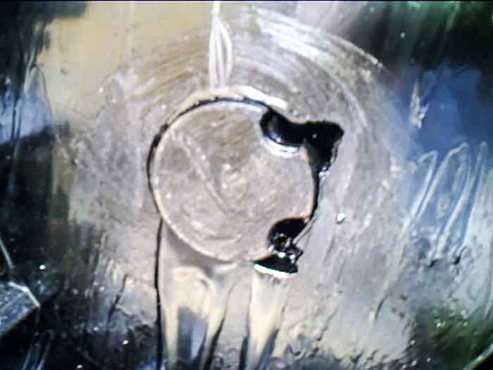

The pump supplier and manufacturer carefully analyzed the pumps with broken or turned shafts. Dimensional checks and metallurgical analysis of the shaft and set screws were conducted. Both were found to be within the manufacturer specifications. Once the pumps were burned out to remove residual hardened asphalt, abnormal wear patterns in the pumps showed excessive discharge pressure had deflected the shaft and forced the rotor into the suction side of the pump casing (see Images 2 and 3).
There were signs of wear on the suction side of the casing where the rotor was pushed into the casing wall. There were also signs of wear on the suction side of the head plate where the rotor deflected into the head. Other signs of wear in the bushing, idler and crescent also indicated overpressure and subsequent shaft bending and deflection. When the rotor pushed against the casing and head, excessive torque caused the shaft to break or turn inside of the rotor shearing the set screws.
The manufacturer analysis read that “subsequent overpressure resulted in shaft bending, which in turn resulted in casing wear, head wear and eventual rotor/shaft assembly breakage.” In some cases, the shaft turned within the rotor, shearing the set screws and disengaging the rotor from the shaft. This analysis led to design changes in the pumps by the manufacturer and an analysis of operating procedures of the process within the facility.
The pump manufacturer’s published maximum discharge pressure is 150 psi in this pump partially due to the shaft size and subsequent length-to-diameter (L/D) shaft deflection ratios. Any excess of 150 psi could cause shaft bending and deflection as was seen in the failures at this facility.
