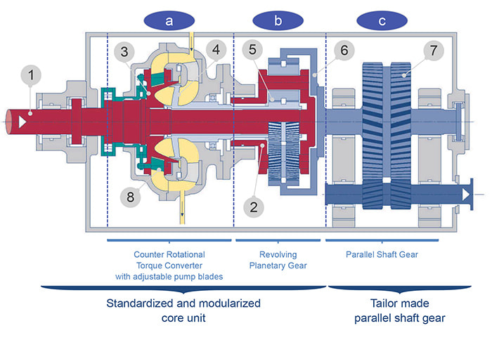

This gearbox is often used in the oil and gas industry as a variable speed drive for pumps and compressors and connects a constantly rotating electric motor to a working machine. An actuator is used for the variation of the rotational speed—in this case, adjustable pump vanes of a torque converter.
The hydrodynamic geared variable speed drive combines a counter-rotational torque converter (a), with a mechanical planetary gear (b) and a parallel shaft gear (c). The geared variable speed drive connects a driving machine, such as an electric motor, and a working machine, such as a pump or a compressor.
The input shaft (1) is connected to the planet carrier (2) of the planetary gear. This means that a large proportion of the input power is transmitted to the planetary gear directly, mechanically and at a very
high efficiency.
Additionally, the pump wheel (3) of a hydrodynamic torque converter is coupled to the input shaft and diverts just a small proportion of the input power. A liquid flow transmits this power from the pump wheel to the turbine wheel (4) of the torque converter. The diverted power is transmitted to the sun gear (5) of the planetary gear. The power from the planet carrier and from the sun gear is combined in the planetary gear, where ring gear (6) transmits the accumulated power to the output gear stage.
The required specified output speed is achieved by the gear ratio of the parallel shaft gear (7). Adjustable guide vanes (8) at the pump wheel control the liquid flow in the torque converter and determine the speed of the turbine wheel. This allows the speed of the driven machine to be infinitely adjusted.
In previous machine concepts, the design and adaptation of the core machine, in particular the gearbox parts, and thus the gear ratios, were executed on an order- and project-specific basis according to required speed and power. Thus, only a small standardization depth was possible and the engineering effort was high, adversely affecting both delivery time and product costs.
The new gear concept makes it possible to separate the core machine from project-specific parts, which is the basis of any modularization and standardization: defined interfaces between customer-specific (customized) and modular units. In the case of the hydrodynamic transmission, this interface represents the connection between the ring gear of the planetary gear unit and the input shaft of the parallel shaft gear stage.
