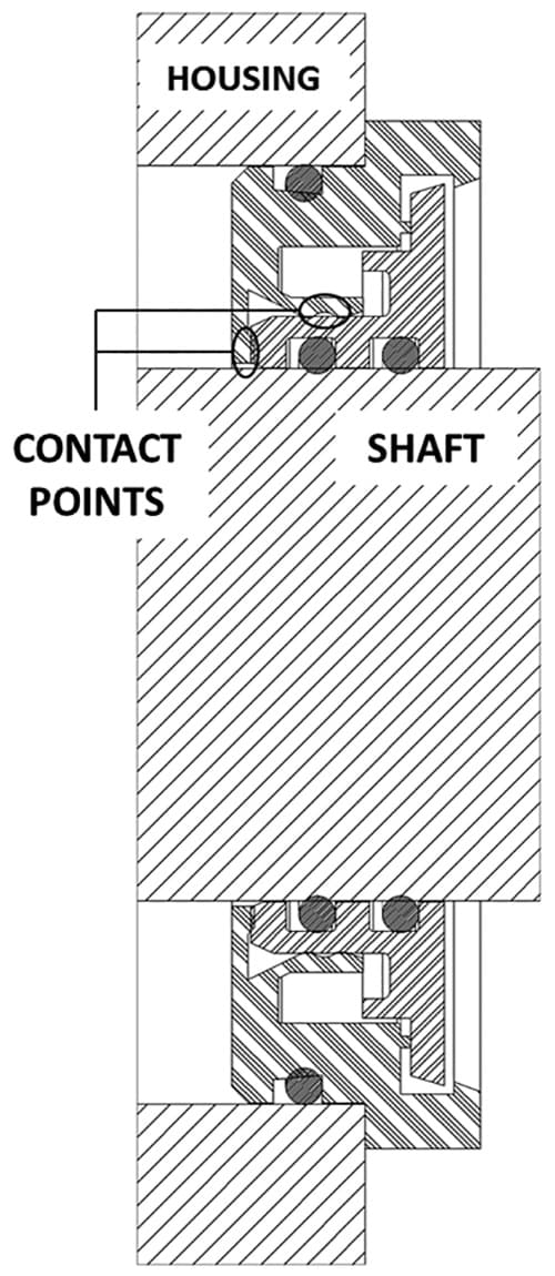

Recent advances in bearing isolators include the ability to be used in submerged or flooded conditions. These hybrid bearing isolators combine the benefits of a non-contact, labyrinth-type seal and a contact-type seal to hold a full head of lubrication (see Figure 5). This makes them suitable for use in oil mist applications to prevent the mist from migrating into the atmosphere. Operators should note that these hybrid bearing isolators could be made of steel, which is a sparking material.
