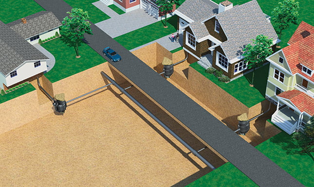

Most homes built before 1970 are connected to a sewer through a gravity sewer system. A gravity sewer system collects wastewater from homes and transports it to a collection line by allowing gravity to force the flow. Collection lines are pipes that are installed at a slope to keep both water flowing and solids in suspension. A gravity sewer system involves digging wide, downward-sloping trenches. This method works for downhill grades but is challenging when the terrain is rocky or slopes uphill. Other challenges include a high percentage of sandy soil, proximity to water or long piping runs. Lift stations are often combined with gravity sewers to “lift” the sewage flow and ensure that it keeps moving. A pressure sewer system can offer a more effective and less costly method for sewage transport. First used in the early 1970s, a pressure sewer system uses a grinder pump located either outside the home or in a home’s lower level or basement. The grinder pump moves the home’s wastewater through small-diameter service lateral pipes to a larger collection system. Today, pressure sewer systems provide daily service to more than half a million users worldwide and range from a single pump to thousands of pumps. A pressure sewer system provides excellent performance, high reliability, low upfront infrastructure costs, and affordable operation and maintenance costs.

Pressure sewers differ from gravity sewers, in which sewer pipes are necessarily larger (because they are not under pressure) and wastewater can only be conveyed downhill. In the instance of RS&W’s Hideout community, the minimum sewer diameter in the failing gravity system was 8 inches, and ground elevation variations within the community exceeded 210 feet. In the upgrade to a pressure sewer system, new sewer pipe diameters range from 1.25 to 4 inches. These new pipes can convey wastewater across the full range of the community’s elevation changes. A typical installation includes:- A sewage basin or tank
- A grinder pump
- A lifting device to remove the pump for inspection and maintenance
- A check valve on the pump discharge line to prevent backflow when the pump switches
- A 4-inch basin inlet pipe from the home
- A small alarm panel on the side of the home
- A vent on the top of the tank
- A cover with optional access doors
- A curb box that will contain a shutoff valve to separate the pump from the system and a redundant check valve to maintain isolation between the tank, station and complete system
- Level sensors and an optional cable holder
- A junction box or electrical connection

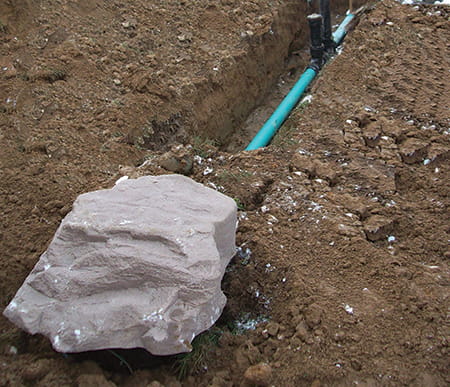

Pressure sewer systems have key advantages when compared with gravity sewer systems. These advantages can be categorized in five areas, which are described in this section.1. Smaller Pipes

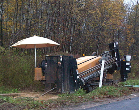

Smaller pipes requiring narrower and shallower trenches reduce material and installation costs. In some cases, piping can be installed using a technique called directional boring. Directional boring allows for installation of pipelines underground without an open trench. Directional boring involves an operator steering a small drill underground. The drill can turn corners, go uphill or downhill, or move around a tree with virtually no environmental impact. Although directional boring was not employed in The Hideout, the smaller pressure sewer pipes represented a significant advantage for RS&W stakeholders. The design eliminated the need for the wider and deeper excavations with a gravity system.![Directional boring at a pressure sewer installation in Hastings New York](/sites/default/files/0914/directional-boring.jpg)
