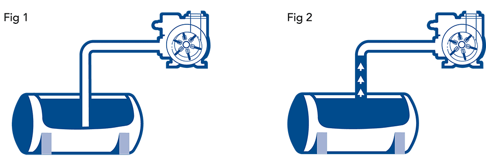

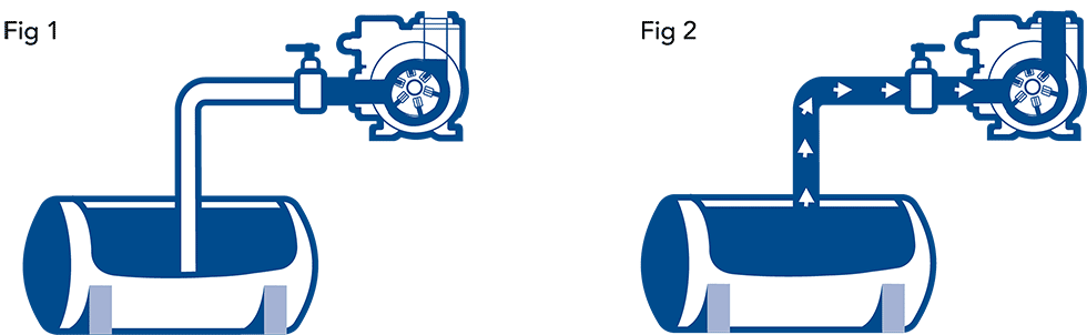

In all high-suction applications, the pump will have to be primed before it can begin to operate safely and effectively. With that in mind, there are two types of priming that can be incorporated depending on the pump’s setup: wet or dry. (See the sidebar for a closer look at dry priming.)
In general, wet priming occurs, as the term suggests, when there is residual fluid left in either the piping or the pump itself. Any fluid that remains in the piping will have surface tension, or the fluid may be intentionally trapped within the piping or pump via use of a foot or similar valve. This enables the inlet to be wetted with liquid before operation begins, and this wet suction lift condition will improve the pump’s overall suction lift capabilities. It also makes priming the pump easier and offers such benefits as the ability to produce up to five more feet of suction lift at startup and to pump liquids with higher viscosities.

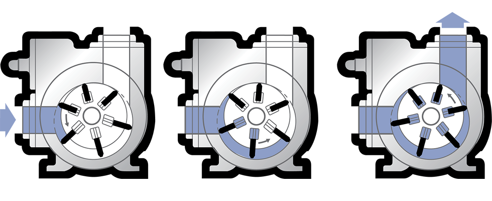

The secret to the sliding vane pump’s success in creating high suction-lift values is found in its unique design and method of operation. Sliding vane pumps have a number of nonmetallic vanes. When the pump driver turns the rotor, a combination of forces—centrifugal (pump speed), mechanical (push rods) and hydraulic (liquid pressure)—force the vanes out of their slots and into the walls of the pump casing, creating a seal between the two. As the vanes rotate in the cylinder, a vacuum is created at the inlet of the pump. Because sliding vane pumps can run dry, there is no risk of overheating or excessive cavitation within the pump as the pump creates suction.
Additionally, during the priming process, any air or vapor that is in the pump or piping needs a release, as a pressurized discharge will prevent the pump from priming. In this instance, sliding vane pumps can be outfitted with a supply vessel, which allows the dissipation of any air or vapor that is present.
