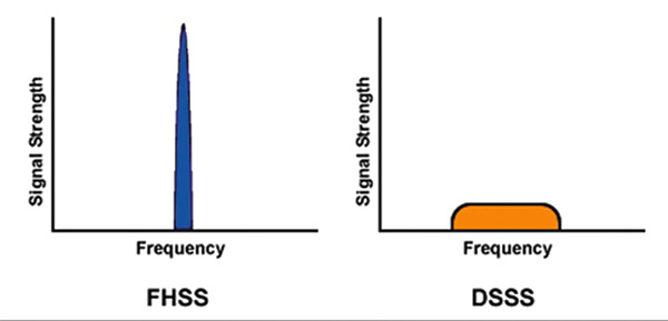

The signal strength of an FHSS wireless data radio is much stronger than other options, such as direct-sequence spread spectrum (DSSS).

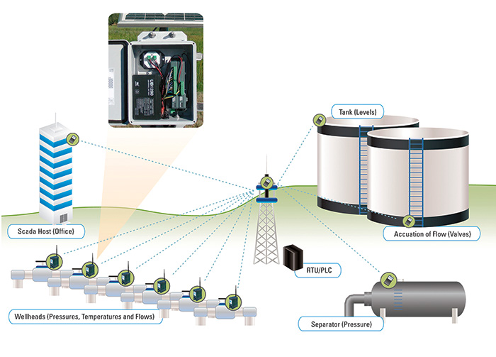

The first is the field automation counterpart of the wide area network (WAN), which can extend 10 to 100 miles. This network, often referred to as the “backbone” or “skeleton,” consists of a series of repeaters connecting the host computer to all the remote locations. Depending on the technology, this repeater network can offer high-speed throughput and the ability to bridge many physical obstacles—such as hills, valleys or buildings. The backbone network can cover greater distances than a single radio link. By using multiple repeaters, data can be rebroadcast and will regain full signal strength at every repeater.
With telemetry technologies, such as spread spectrum radio, the same radio used in the RTUs can act as a slave sending data back to the SCADA host. It also acts as a repeater to other field devices or other RTUs. This allows almost limitless expansion of a network by using remote sites as a series of repeaters.
The network uses radios in the RTUs to poll the instruments, creating the second network—a network of instruments that wirelessly reports to the RTU. This short-haul network is equivalent to a local area network (LAN).

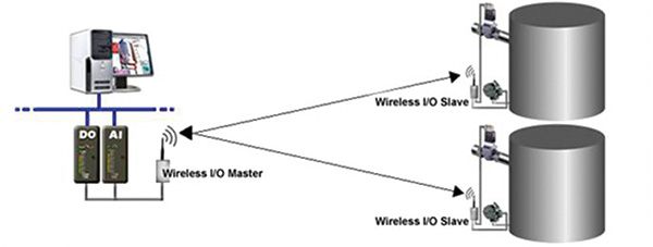

New technology features two interlacing networks—the WAN and the LAN—that work on one radio system with a common connection. This common connection is the “slave/master” switchable functionality of the single radio used in the RTU. The radio installed in the RTU is a slave to the SCADA host and a master to the wireless I/O (see Figure 1).
Figure 1. Some providers offer wireless I/O radios that can act as both a slave and master.
An example of a wireless I/O network
