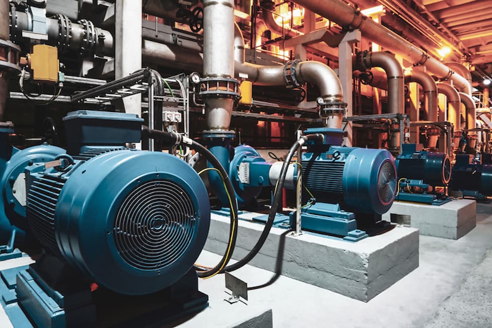

IMAGE 1: Condition monitoring of balance-of-plant rotating equipment has commonly been accomplished via a route-based method. (Images courtesy of Schaeffler Group USA Inc.)

Monitoring the condition of bearings installed inside motors, pumps and other balance-of-plant rotating assets has commonly been accomplished by trained professional vibration analysts—aided by complex software and a portable data collector. Using the route-based technique, the analyst will usually walk a predetermined path within the plant, stopping at each machine and taking readings of vibration data using an accelerometer and the above-mentioned collector. After the route is completed, the collected data is uploaded to a host computer, where, typically, a more experienced analyst reviews and analyzes the data to determine if there are any machine faults. This condition monitoring method produces large amounts of data, requires (usually several) human experts to operate, has time constraints, and is prone to missing important machine faults if not performed consistently. Notably, significant time can be spent on machines with no problems. Of course, additional safety considerations, such as having personnel exposed to the potential hazards of rotating machines, are also in play.
