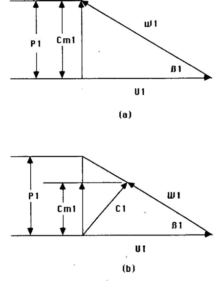

Figures 1a (top) and 1b (bottom)
The Equations
Figures 1a and 1b show two different inlet velocity triangles. For maximum pump efficiency, the eye is designed for no pre-rotation at the best-efficiency-point (BEP), as shown in Figure 1a. The capacity of such an eye can be calculated with Equation 1.
Q1NP = Nb1D1m (πD1m sin β1m - t1'Z) / 73.5 cos β1m   (1)
To reduce the NPSH requirement at the BEP, the eye is made larger, with a resultant pre-rotation, as shown in Figure 1b. (Pump efficiency will be reduced.) When there is enough pre-rotation for C1 to be at a right angle (90 degrees) to W1, the capacity of the eye may be calculated with Equation 2.
Q1OPT = Nb1D1m cos β1m (πD1m sin β1m - t1'Z) / 73.5  (2)

Q1NP = (3530) (1.06) (2.75) [π2.75sin17° – (0.19) (5)] / 73.5 cos17° = 233 U.S. gal./min.
Q1OPT = Q1NP cos2 β1m = 233 cos217° = 213 U.S. gal./min.
The calculated Q1OPT is right at the Qbep as shown by the published curve, indicating an eye designed for the "optimum" capacity.
