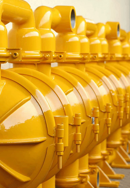

What Are AODD Pumps?
Positive displacement (PD) pumps are powered by air, such as the AODD. To fill and empty the pumping tanks, diaphragms move in opposite directions. The pump action is created by the diaphragms pumping air in and out of chambers on the opposite side of the diaphragms.
This pump type is used for transfer applications and can manage a wide range of input materials, including solid waste, liquids with high shear and abrasives. As a result of their sturdy design, they are not susceptible to freezing and can be used in low-pressure with variable flow situations.
